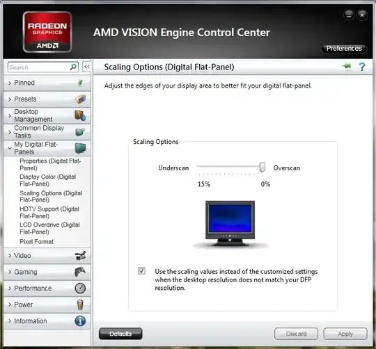

Edit: since quite a lot has changed in the drivers (version 2011.0419 as of this writing) since I initially wrote this post, I decided to update it. The procedure is now drastically simplified:
  • right click on the desktop and choose AMD VISION Engine Control Center
Menu option
  • from the left side of the window go to My Digital Flat-Panels and choose Scaling Options (Digital Flat-Panel)
AMD vision blah blah blah settings
  • set the slider to 0% (or whatever works best for you) and you're done.

I made a short tutorial in case others are interested in changing this setting. To adjust Underscan/Overscan in Catalyst Control Center (version 9):
  • right click on the Desktop and choose Catalyst(TM) Control Center
  • from the upper left side corner, left click and choose Desktops & Displays
  • find the display you want to configure and right click on its icon from the lower part of the window and choose Configure
  • go to the Scaling Options tab and adjust the slider as you see fit (for me it's 0%, so the image can fit the entire TV screen) and click Apply
