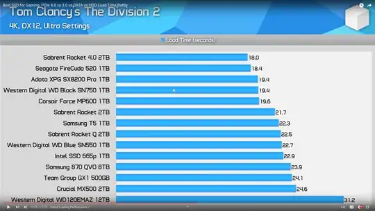

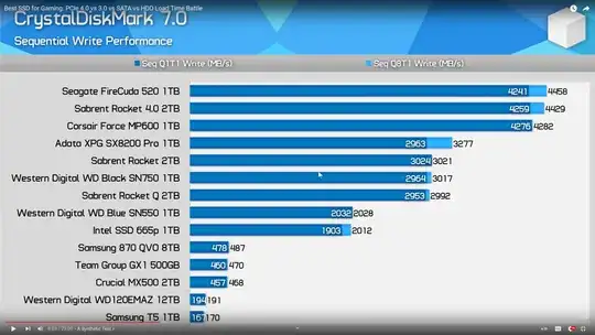

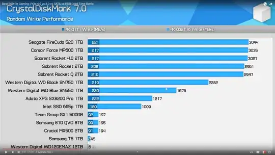

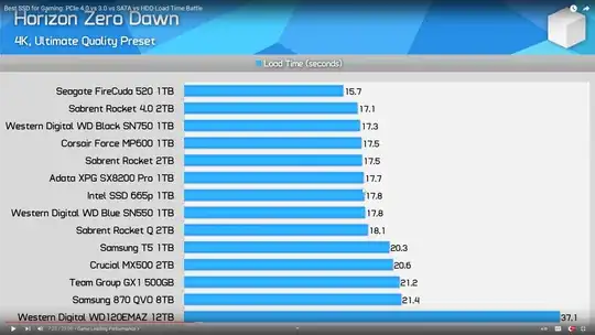

In answer to the request for data for game performance as vs disk-type, I found it in the YouTube episode of Best SSD for Gaming: PCIe 4.0 vs 3.0 vs SATA vs HDD Load Time Battle.
In this episode, the load-time for seven games was measured on:
  • PCIe 4.0 : 3 SSDs
  • PCIe 3.0 : 4 high-end SSDs and 2 entry-level SSDs
  • SATA 3 : 4 SSDs
  • 1 SATA III HDD
Below are screenshot extracted from the video.
CrystalDiskMark synthetic/artificial performance tests
Sequential Read Performance
The disks here are nicely ordered by technology, in exactly the same order as in the above list.
Sequential Write Performance
Random Read Performance
Random Write Performance
Games load time
Horizon Zero Dawn
Death Stranding
Shadow of the Tomb Raider
Red Dead Redemption 2
Borderlands 3
The Outer Worlds
Tom Clancy's The Division 2
Planet Coaster
Conclusions
  • There are dramatic differences between HDD and SSD for almost all types of games.
  • PCIe SSD drives were on average just seven percent faster than non-PCIe drives for loading into the game, which is pretty negligible. There was no clear advantage to PCIe 4.0 drives at all.
  • For SSDs, there is no clear preference for PCIe over SATA, as the results differ between game types, or at most a negligible advantage for PCIe.
  • In these sorts of games there is far more processing work that goes on when loading a level than copying from storage into system or GPU memory. It's much more important to have a fast system overall than is having a blazing fast SSD.

  • The setup and tests in this video are the opposite of my question. I'm looking for performance data when the game drive is fixed (preferably on a PCIe drive) and the OS drive differs across many different hard drive technologies. – LowTechGeek Nov 17 '21 at 05:43
  • Although, this is the first test I've seen that uses a separate OS disk, so kudos for that. Too bad though that they don't give the specs on that disk (they classify it only as an "M.2 disk"). – LowTechGeek Nov 17 '21 at 05:50
  • The disks specs are available on the web. You may learn from this benchmark about the behavior of "real-world" applications, as it included so many types, but with quite uniform results. The biggest jump in performance is by using SSD. Then you will have a slight improvement going from SATA to PCIe 3.0 and then to PCIe 4.0, also an additional slight improvement by using a higher-end SSD. Besides absolutely needing to use SSD, the rest is up to you according to your budget - the differences will be very slight. My interpretation is that a higher-end SSD may help a bit more than PCIe 3.0. – harrymc Nov 17 '21 at 09:43
