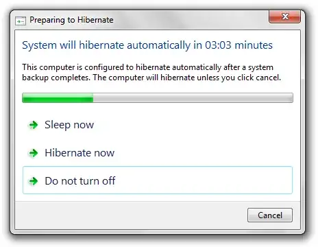

I am working on developing have created a light application which displays a countdown before putting the computer to sleep or hibernate, and runs after a backup. This makes the computer go to sleep when the backup is done, but give the user a chance to cancel the shutdown if they happen to be up late working. You can download it here. The installer automatically sets up the scheduled task, but you will need to install .NET 4.0 manually if you don't already have it.
AutoShutdown
