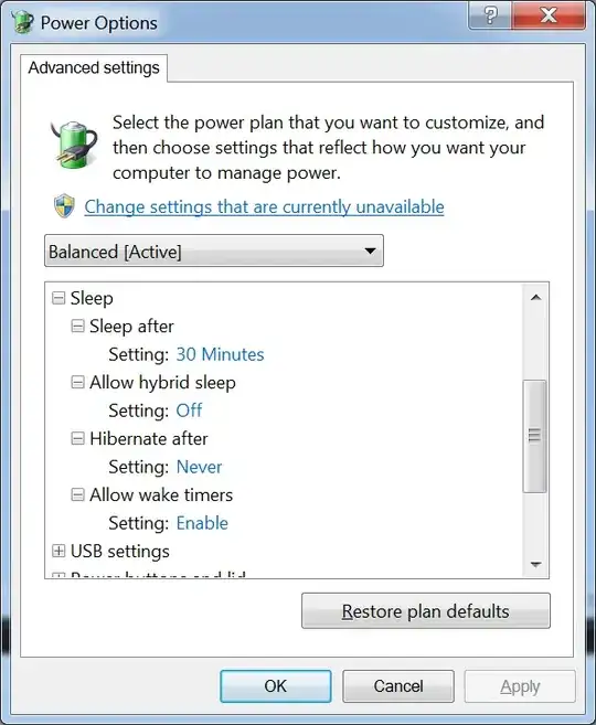

I'm got a custom built PC running 64 bit Windows 7 Ultimate. So far everything works great except for one thing: it will not wake up from sleep mode for a wake timer or scheduled task.
Sleep mode itself works great. If it's sleeping, it wakes successfully when I press the power button, mash the keyboard, wiggle the mouse, or send a WOL packet. The only problem is wake timers. I even tried the program WakeupOnStandBy but it looks like that uses wake timers, so it doesn't do anything for me either.
And yes, wake timers are enabled:
Any ideas on how to fix the problem, or troubleshoot it? I'd imagine that there would be a log somewhere telling me exactly why the wake timers are having trouble, but if there is I haven't found it.

Check out your Power Management Options on your Control Panel:
  1. Start,
  2. Control Panel,
  3. Power Settings,
  4. Change plan settings,
  5. Change advanced power settings). -> “Sleep” option, “Allow wake timers.” ->"Enable"
I had the same issue and fixed this way.
