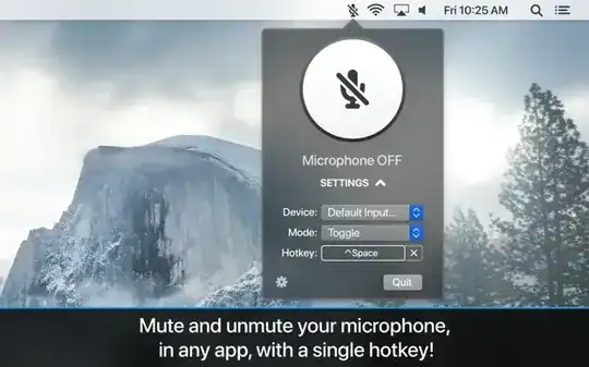

For people reading this question that have touchbar Macs, consider MuteMe - it adds a button in the global touchbar area for mute/unmute (and the button turns red when muted). If you don't have a touchbar Mac, you can still use it either from the system tray or as a global keyboard shortcut. It is free.
Just tried MuteKey on macOS Big Sur and it did the job very well. On my default installation, the hotkeys were ⇧ Shift+⌘ Command+W; I had to select Device > All Input Devices to get it working globally.
