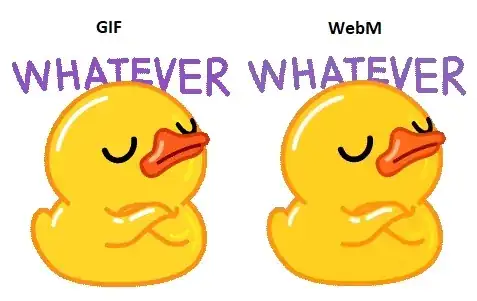

The colors come out fine when I try using VP8 WebM or H264 MP4, but whenever I use VP9 WebM there's a slight change in color. The change in color can be seen in Chrome, not sure about other browsers or viewers. I also tried ezGIF online GIF to WebM converter (which uses FFmpeg under the hood), and it worked fine (colors remained the same), so I'm not sure why it's not working correctly when I run FFmpeg locally.
Command I used:
ffmpeg -i duck.gif duck.webm
Color difference screenshot:
Duck Color Difference
Orignal GIF: Original Duck GIF
Output WebM: https://sportyz.000webhostapp.com/duck.webm

  • Try the following command: `ffmpeg -y -i duck.gif -vf scale=out_color_matrix=bt709:out_range=tv -pix_fmt yuva420p duck2.webm` when using `out_color_matrix=bt709:out_range=tv` the color looks the same to me as the animated gif. Please check if the colors are the same. – Rotem Oct 26 '22 at 19:46
Adding -vf scale=out_color_matrix=bt709:out_range=tv to FFmpeg command seems to solve the issue.
"Just in case", we may also mark the stream Metadata as BT.709 and "TV Range":
ffmpeg -y -i duck.gif -vf scale=out_color_matrix=bt709:out_range=tv -pix_fmt yuva420p -bsf:v vp9_metadata=color_space=bt709:color_range=tv duck2.webm
For non-HDR video there are two mainly used color standards: BT.601 and BT.709.
The difference is the conversion matrix from RGB to YUV color space.
There are also two main color ranges for YUV: "TV Range" applies values in range [16, 235], and "PC Range" applies values in range [0, 255].
It looks like FFmpeg uses BT.601 conversion by default (when encoding VP9), while Chrome assumes BT.709 standard (when decoding VP9).
The result is a noticeable "color shift".
For overcoming the issue, we may select "BT.709" and "TV Range" explicitly.
  • scale=out_color_matrix=bt709:out_range=tv - enforces conversion from RGB to YUV using BT.709 conversion formula, and "TV Range" range.
  • -bsf:v vp9_metadata=color_space=bt709:color_range=tv sets the stream Metadata to BT.709 and "TV Range" (probably not required).

  • It's super close. looks about 95% the same, but still ever so slightly different. The difference is more noticeable if you put the 2 images in 2 different tabs and switch between them, especially if you zoom in the page to say 200%. The conversion using a palette on the other hand is 100% perfect (except the white background issue). If there is no way to get a palette conversion working together with transparency I will use your solution, as most people will never notice the difference anyway. Thanks for the help and time you put into this. – SportySpice Oct 26 '22 at 21:31
