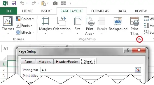

If you're using Office 2010, under "File -> Print -> Page Setup -> Sheet (tab)", the setting for "Print area" should be what you are looking for. In my example, only columns A:J will be printed; however, everything is shown when viewing on screen.
This is what the dialog looks like:
Screenshot
(Click image to enlarge)
This may also be accessible as "Page Layout" → "Page Setup" → (corner button) → "Page Setup" → "Sheet":
