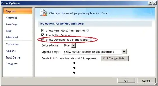

The first step is to add the Developer tab to the ribbon.
In Office 2007,
  1. Click “Office Menu” -> “(Program) Options”.  (“Office Menu” refers to the Office button button in the top left corner.) This brings up a menu that has an “Excel Options”, “Word Options”, etc., button at the bottom.
  2. In the options dialog box, check “Show Developer tab in the Ribbon”: Office menu and click “OK”.
  3. Your new “Developer” tab should be showing.
