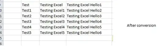

Recently i came across excel with cells filled with small cases,Is it there any easy way or macro to capitalize each word of the excel?
For E.g Consider the below image :
Before conversion
After conversion it should look like as below :
After conversion
I need to capitalize every cell[Entire cell] in excel with first letter as capital?any easy way to accomplish it?

    The "Proper" function can do what you want. E.g. Putting `=proper(H1)` in a helper cell will give `Upload File With Irregular Format` there. – K. Rmth Jul 07 '15 at 10:57

There's no need to use VBA to change any cases. There are certainly VBA functions that do this as shown by other answers but, unless you're already writing something in VBA, this is overkill.
The following formulas will convert cases for you.
=UPPER(A1) converts all letters to uppercase
=LOWER(A1) converts all letters to lowercase
=PROPER(A1) converts the first letter of each word to uppercase and every other letter to lowercase
(A "word" is a consecutive string of letters. Any non-letter is considered the end of a word.)
Here are examples of the results:
Input:    Aaa bbb-ccc/ddd=eee9fff"ggg\hhh{iii(jjj
Upper:  AAA BBB-CCC/DDD=EEE9FFF"GGG\HHH{III(JJJ
Lower:  aaa bbb-ccc/ddd=eee9fff"ggg\hhh{iii(jjj
Proper: Aaa Bbb-Ccc/Ddd=Eee9Fff"Ggg\Hhh{Iii(Jjj
If you want to capitalize only the first letter of a cell, combine UPPER with some other functions:
=UPPER(LEFT(A1)) & MID(A1,2,LEN(A1))

  • Sorry, how does this work? I mean, if I have a value in A1, and want to keep that value in A1, how can I use a worksheet formula? Or would I need to copy everything else where, and then copy it back (which is easy enough) – Dave Jul 07 '15 at 13:06
  • If you want to keep it in the same cell then you are correct. You must create a second column with the formulas and then copy / paste values over the original data. That's the only drawback against VBA: It can't edit the data in-place. – Engineer Toast Jul 07 '15 at 13:18

I need to capitalize every cell in excel with first letter as capital?any easy way to accomplish it?
Yes, use this macro. Remember to take a back up of the file first!
Sub uppercase()
For Each cell In Application.ActiveSheet.UsedRange
    If (cell.Value <> "") Then
         cell.Value = UCase(cell.Value) ' this will make the entire cell upper case
    End If
Next
End Sub
To make the first letter of each cell upper case you'd use
cell.Value = UCase(Left(cell.Value, 1)) & Right(cell.Value, Len(cell.Value) - 1)               'This will make the first word in the cell upper case
To make it title case, use
Sub titleCase()
         cell.Value = TitleCase(cell.Value) ' this will make the entire cell upper case
    End If
Next
End Sub
Function TitleCase(s) As String
a = Split(s, " ")
For i = 0 To UBound(a)
    If (Trim(a(i)) <> "") Then
      TitleCase = TitleCase & UCase(Left(a(i), 1)) & Right(a(i), Len(a(i)) - 1) & " "
    End If
Next
TitleCase = Trim(TitleCase)
End Function
