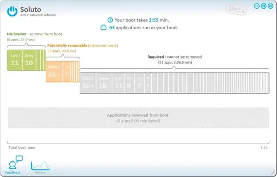

UPDATE: Soluto has moved on and its software relates now to the mobile world.  Soluto’s original “Anti-Frustration Software” is no longer available from the manufacturer; one would need to look on the Internet for an old version of it, which might not still work after all.
A pity, since it was a rather unique product.
Here is an archived copy of their website.Their URL now redirects to asurion.com, which appears to offer technical services, but no products.
Soluto is an excellent boot-analysis product.
For more info see: Soluto Figures Out What’s Bogging Down Your PC (And Tells You How To Fix It).
screenshot of Soluto’s “Anti-Frustration Software”

  • +1 I forgot that Soluto shows you the individual seconds spent, and it's user-friendly. – Tamara Wijsman Feb 25 '11 at 17:09
