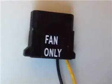

  2. PSU's with specially marked Fan-Only PSU connectors (Antec TruePower 550W) can adjust the speed of the fan:
