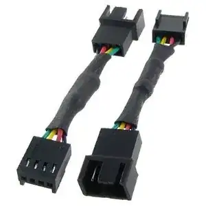

Yes, on molex they will run at 12volts witch is the maximum of a normal desktop fan (producing the maximum speed).
If you think that it is too loud, then buy one of these resistances: enter image description here
You can easly find them at almost any computer parts store.

  • Are they tunable or do they just step down the voltage? – TheLQ Dec 29 '12 at 20:42
    They reduce the voltage. To be able to change you must get a fan controller. – SOMN Dec 30 '12 at 01:13
  • @TheLQ [Fan controllers](http://www.newegg.com/Product/Product.aspx?Item=N82E16811995074) typically just have variable resistors (usually a potentiometer) somewhere accessible, e.g. on the front panel. Smarter ones may even have built in temperature monitors and circuitry to automatically adjust fan speeds. – Bob Dec 30 '12 at 14:26
  • You can, of course, make your own resistor cable, or modify an existing one with different-sized resistors. – Daniel R Hicks Dec 30 '12 at 14:28
