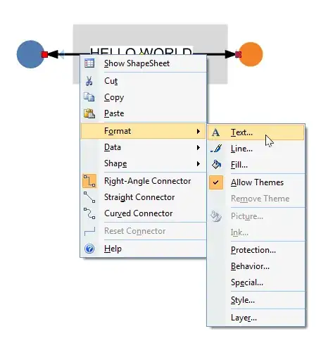

Let's start by recreating the problem: the white background behind the text on the line
Right-click on the arrow and select Format / Text
This will launch the Text dialog. Under the Text Block tab look at the options for Text background. You'll notice that it is set to Solid color.
Now just set it to None and click OK

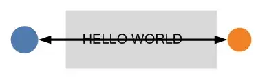

And now you'll see text background is no longer there
Of course, the text can still cover the line or an arrow, but at least the background is gone.
