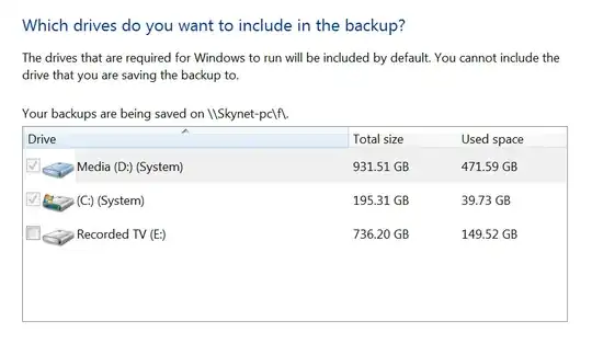

I am trying to create a system image of my OS drive but Windows it trying to make me backup my storage drive as well showing it as a system drive: enter image description here
I only want to back up my Windows drive (C:) but the option to untick the storage drive (D:) is grayed out. I read in this post that I may have inadvertently installed a service to this drive.

I had this same problem, both the C and D drive were required when doing a Windows 7 image backup. I felt it was not necessary to include the D: drive in the image backup.
I have always used the D drive when possible when I installed software. Since I switched to a SSD using D drive became more important (120GB SSD). I found 3 services that pointed to my D drive. I switched two of the programs from the D to the C drive. The third, which is photo editing software, I had already marked as disabled. I deleted the service in the registry in HKEY_LOCAL_MACHINE\SYSTEM\CurrentControlSet\Services\

Had the same problem and the solution is in Windows disk management you need to temporarily set your D: drive or others to offline. Then you can configure Windows Backup for C: system image without other drives. Now backup works as expected and you can set your offline drives to online again. enter image description here

Well, I fixed this problem really easy. So, yeah dude. At first I couldn't de-select my 'D' drive (this never happened to me before); I just wanted to image my 'C' drive only. So to fix this weird glitch I went to computer management by right-clicking on my computer and selecting "Manage", then I opened 'Disk Management', then I right-clicked the 'D' drive and clicked on ‘change drive letter’, then I removed the drive letter completely. Then I closed the "Disk Manager". Then I did a ‘dry run’ on the system image backup process, and of course I couldn't see my 'D' drive in the list of what you want to include in the image backup. I cancelled the ‘dry run’ of the image backup - and went back to ‘Disk Management’ and added the drive letter back - I added "D" again - then closed the disk manager, then I ran system image backup and it worked normally, 'D' drive was no longer force as a second system drive. Ta-Da !!!!
