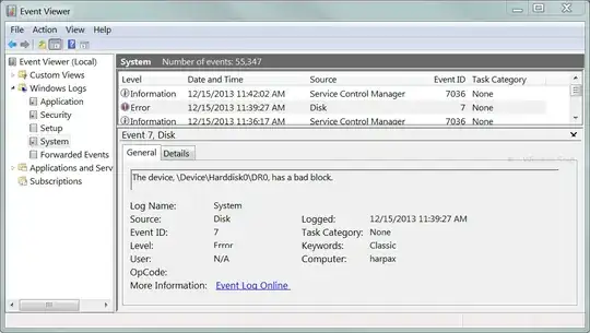

Hard drives today try to hide bad sectors from the host computer. The host computer simply asks the drive to return the contents of a particular sector number. Normally the drive reads the sector, returns it to the host machine, and everything is fine.
The hard drive knows if the value it read is valid or not, because the drive uses Error-correcting code (ECC) to validate that the contents it read are correct. If the drive detects that the contents of the sector are invalid, it will retry the read. The hope is that if it simply reads it again, it might get the correct sector contents. It will keep retrying until it gets a good value, or it's reached it's time limit (formally known as the Command completion time limit, or CCTL).
During these retries, the drive will appear dead; as it is no longer responding to commands.

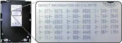

Bonus Chatter: In the olden days, your hard drive shipped with a sticker fastened to it. This sticker contained the Factory Defect List; the list of all known bad spots on the drive.
If you performed a low-level format of the drive, you had to use a tool to type in all the Cylinder-Head-Sector locations of the bad spots.

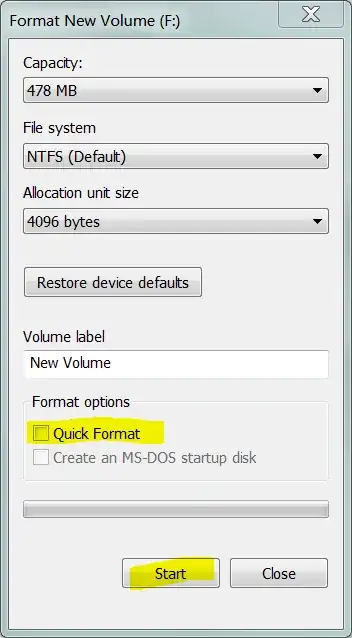

Note: It's not strictly necessary to use a "low level" tool like Western Digital's Data LifeGuard. If you instruct Windows perform a full format (i.e. non-Quick format) of a volume, it will writes zeros to every sector in the volume.
