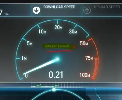

i'm from Malaysia. I am subscribed to 2mbps pack from my country's ISP. But all i get is only 200kbps when download files from the internet, when i test my speed on speedtest.com , it shows me 1.7mbps.
I am pretty confused , ISP should give users what they stated , yeah a 2mbps. But i only recieved 200kbps and the speedtest shows 1.7mbps which makes me confused even further.

  • http://www.speedtest.net/result/1942446908.png – ETAN May 10 '12 at 07:44
  • sorry about the confusion , typo, my speedtest it 1.7mbps , and my download speed is 200kbps(kilo byte per second). – ETAN May 10 '12 at 07:45
  • currently running the glasnost test. – ETAN May 10 '12 at 07:47
  • You sure it's kilobytes? Because your speed test result is likely megabits. 1.7 megabits is equal to about 210 kilobytes - 8 bits to a byte. See http://superuser.com/a/51745/117590 – Bob May 10 '12 at 07:47
  • it says "1.7Mbps" is it megabits or megabytes? – ETAN May 10 '12 at 07:49
    b = bits , B = bytes – Akash May 10 '12 at 07:56
  • Your speedtest shows 1.7Mbps, your connection is 2mbps, your download speed is approx 200kBps. I dont think anything is wrong. You can cancel the glasnost test – Akash May 10 '12 at 07:57
  • that's it i got confused between MBps and Mbps. thanks Akash for the advice. – ETAN May 10 '12 at 07:59

Actually the internet service providers mentioning our internet speed in bits per second.
And your speedtest website also showed it to you in bits per second ,whatch it clearly.
But in our computer level,our download managers or some applications shows the download speed in Bytes per second like this,
8 bits = 1 Byte
So if your ISP mentions 512 Kbps , 1 Mbps , 2 Mbps , 4 Mbps ., to calculate your download speed in Bytes simply divide it by 8 , that will be your download speed in KiloBytes or MegaBytes . example
512 Kbps = 64 KB/s
1 Mbps = 1024 Kbps = 128 KB/s
2 Mbps = 2048 Kbps = 256 KB/s
4 Mbps = 4096 Kbps = 512 KB/s
