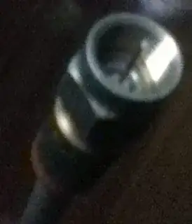

  • It says it's thompson. Also took a picture with ipod but bad lighting because the cable is in an awkward position: http://i.imgur.com/aB9OT.jpg – Joan Venge May 23 '12 at 00:36
  • Modem is thomson dcm475. – Joan Venge May 23 '12 at 00:39
  • Btw I am posting this from ipod, that's slow to make changes to the question. – Joan Venge May 23 '12 at 00:41
    Get some better lighting on it so we can see in the end of it. You say there's no center pin/wire, a blip of light seems to make it have one. – Fiasco Labs May 23 '12 at 00:58
  • As Fiasco said, please retake the picture with better lighting. I tried to enhance it a bit, but there's only so much you can do... – iglvzx May 23 '12 at 01:00
  • lol guys I only have ipod to take pics and there is no light in that room and the cable barely reaches the window and it's already dark outside. – Joan Venge May 23 '12 at 01:03
  • New pic lighted with cell phone, actually it was the male version my bad: http://i.imgur.com/VSPGd.jpg – Joan Venge May 23 '12 at 01:09
  • Yep, that was what I was expecting to see. Any place that services cable tv will have these pre-made up (cable tv patch cable). In the states Radio Shack tends to be the place to go, though Walmarts carry them. Your cable guy just pulled some coax off a reel and crimped the ends on. – Fiasco Labs May 23 '12 at 01:31

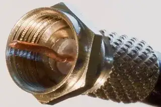

I would guess that it is most likely an F Connector: http://en.wikipedia.org/wiki/F_connector enter image description here
Yes Canadian Tire would most likely carry an F Connector. If not you can easily purchase these connectors (or already crimped cables) online (just search google for it).

  • Thanks mine is that except it doesnt have that bronze colored pin in the middle. Does it matter? – Joan Venge May 23 '12 at 00:49
  • You may be describing the female version of this. Most cable connectors are described as male or female for fairly obvious reasons. Is this more what you are talking about? http://www.alibaba.com/product-gs/241830874/BNC_Connector_Female_to_F_Connector/showimage.html – jds May 23 '12 at 00:53
  • Thanks gotcha I will get the female version then. The input also is solid and has no hole, anyway. Other than this there would be no other f connector right? i.e. bigger radius connection, etc? Lastly would extending this have any impact on the speed of the connection? – Joan Venge May 23 '12 at 00:56
  • There is no other version of this connector in widespread use, no. Extending the cable should have no noticeable effect on the speed of the connection. (As long as you use an appropriate shielded cable). See the discussion here: http://www.dslreports.com/faq/5420 – jds May 23 '12 at 01:00
