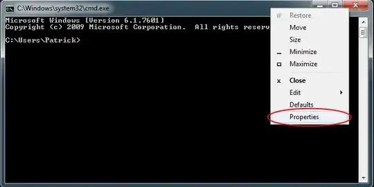

The correct way to permanently set the colors (and other parameters) of a console/command-prompt is to:
  1. Open a command-prompt
  2. Right-click the titlebar or press Alt+Space
  3. Select Defaults from the context-menu
  4. Set the properties you would like (colors on the Colors tab)
  5. Click OK
The method that Tapped-Out gave works because Windows 7 happens to have a bug where the Properties option modifies the default values instead of just for the current console, and it could be fixed at any time.
The method that Indrek gave works as well, but using the provided interface is easier (and safer) than manually editing the registry, especially when setting the colors since you don’t have to mess around with hexadecimal values. Also, you don’t have to worry about setting permissions with the interface.

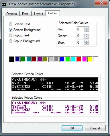

In cmd, right-click on the title bar and select properties:
title bar context menu
Click on the Colors tab:
properties - colors tab
You can change the command prompt's color settings here. From my testing, it globally alters the color scheme.
