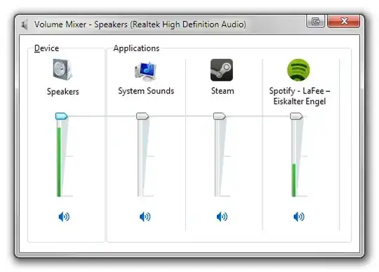

My settings all seem fine. This is my audio slider. (Took the screenshot while the issue showed.)

The main Windows volume may be 100%, but is the individual application volume still 100%?
When it happens, click the speaker in the tray and select "mixer". See if your player volume is down for some reason

  • Yeah, I checked. [Screenshot](http://i.imgur.com/NW0O7.png). The green bar goes up all the way regardless of actual output. As for the speakers, I doubt there's any physical cause for this, seeing as it randomly goes up and down without me touching anything. – Arda Xi Jul 17 '12 at 15:52
