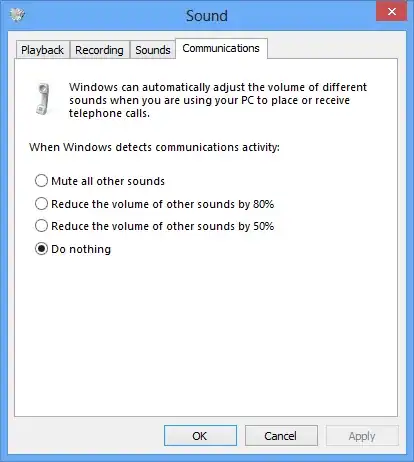

Randomly, or at system sound (usb connect for example) Windows 8 lowers the volume of all other sources. (Same problem can exist on windows 7, just look online).
This is happening because of the "communication detection" made to detect phone calls and then lower volume. But in my case it happens all the time without reason as if windows always considers myself in a call.
Sound settings
Do any of you have the same problem? is this a driver issue or a windows issue? I know this has been posted many times but they usually just tell you to turn off the setting above. I'm looking for an explanation or a solution :).

  • You said that it’s due to the Communications setting, but in the screenshot, it’s disabled. Are you saying it is happening regardless of the setting? If so, then it’s *not* that since it is disabled; it is something else. – Synetech Oct 21 '12 at 01:31
  • @Synetech no it only happens when it is NOT disabled. Disabling it is the common solution found online. It just lowers the sound even when no voice communication is going on. that is the bug. – cmplieger Oct 22 '12 at 00:33
  • Ah okay, that clears things up. So the question is why Windows thinks communications are occurring when they are not. I note that you said it happens when you plug in USB devices as well. Someone else had the [same issue](http://superuser.com/questions/260973/computer-volume-drops-when-usb-deviced-plugged-in) (probably related to the *random communication detected* issue), but could not find a solution because it stopped happening before they could test. See if changing the sound scheme in the Control Panel to No Sounds has an effect or if it happens with a specific USB device or port. – Synetech Oct 22 '12 at 02:51

An updated driver was released after a while and now it seems to be working well. Sorry for those without new drivers but there might not be a solution.
