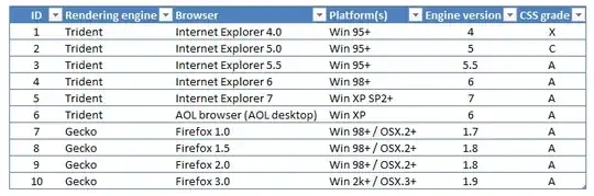

The other method, not mentioned above is to use a Pivot Table.
Let's say this is your table and you want to get the distinct list of Platforms.

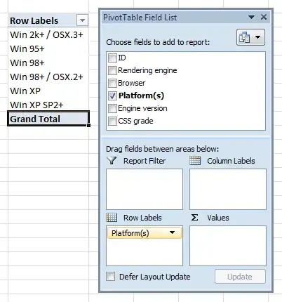

Insert a Pivot Table with the table as your data source.
Now select the Platform(s) column as your Row Labels.
Voila! A list of distinct values.
If you wish to tidy this up, you can switch off Field Headers and set Grand Totals to be Off for Rows and Columns.

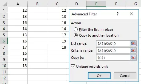

Or you can include the filter option in a macro
Columns("A:A").AdvancedFilter Action:=xlFilterInPlace, Unique:=True
