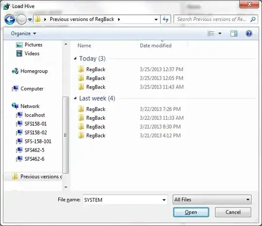

I followed the advice in the answer to a related question here and recovered my previous path setting as of this morning using regedit. Expanding a bit on that answer, here's how I did it. (Read the linked answer to get the full instructions, I don't provide all the details here.)
I selected my earliest backup from today (11:43 AM timestamp in 'Today' section)
Example of previous versions of RegBack
and examined the earliest ControlSet within the HKEY_LOCAL_MACHINE/System node of that copy of the registry file, ControlSet002:
and copied out the previous value of my path variable from the key Control\Session Manager\Environment\Path within that level.
Your mileage may vary, as I don't know exactly what triggers the backup of the registry.

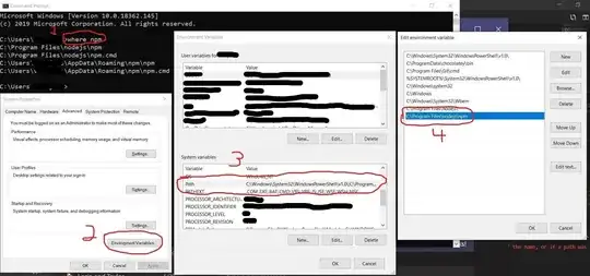

I accidentally deleted the Path environment variable
So did I, and many commands that used to work suddenly produced an error:
The term '<command>' is not recognized as the name of a cmdlet, function, script file, or operable program.
The other answers to this problem didn't work for me, so
I had to recover the Path environment variable a little at a time:
  1. From a plain command prompt, not PowerShell, enter where <command>, e.g., where npm.
  2. Enter "environment variables" in Cortana to edit the system environment variables.
  3. Under System variables, find the Path variable and click Edit.
  4. Add each file path from step 1.
  5. Restart your computer.
  6. Repeat for each command that produces the error.
  7. Enjoy using commands that work. :-)
