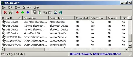

You can also uninstall all previous instances of the device (and the root hubs) using a tool like USBDeview. It will show you all devices that have ever been installed, even if they aren't currently plugged in, and you can uninstall them from there, so the "detected new hardware" thing will pop up the next time you plug it in. Sort them by vendor ID, select everything related to that product, right click, and uninstall them all.
USBDeview showing unplugged devices
I'm not sure if the registry corruption is truly the cause, and I'm not sure if this actually fixes it, but it's worth a try. It seems to be working for my most recent experience with this problem.

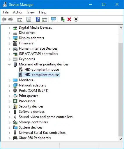

Had similar problem for a year on Windows 10 with my Logitech G102.
Reinstalling driver would not help. And changing ports would help for 10-60 minutes. But here what I noticed, I have two HID-complaint mouse entries in Device Manager:
If I remove one of them in a short time it will reinstall itself. So instead I disabled it (Right Click → Disable device).
Note that for me it worked only when I disabled top one.
Its been two weeks and no disconnects yet!
