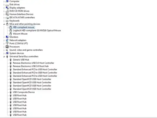

I've looked into Device Manager and everytime the disconnection was happening it was refreshing. I tried turning off the power management off all the USB Root Hub. I don't know what to do anymore.
Here's a screenshot of my device manager : enter image description here

Basically, go into Device Manager, open the USB Controller section, delete all of the "USB Root Hub" by uninstalling them (*I had two instances; some people have more.)
It was a little tricky to delete the 2nd one since my mouse ceased working after deleting the 1st instance. Reboot the computer and Win7 re-installs the standard driver (the USB Root Hub). These were the only 2 fixes I needed for a months-long frustrating problem.
