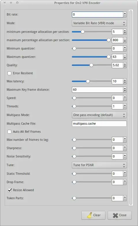

While trying to optimize the size of my home videos I converted some of them to WebM as a test, using Pitivi on Xubuntu. The size difference is significant. The resulting webm-file is only around 10% of the original file, while the picture quality looks pretty much the same to me.
I also tried to do the conversion using avconv so I could script it, but the resulting file looks really crappy. After looking at the rendering settings in Pitivi I tried some parameters: avconv -i $1 -q 5 -qmin 0 -qmax 63 ${1%.*}.webm, but the quality still looks like crap, so it seems I'm missing/using some wrong paramters. Does somebody know which are the correct parameters to use to convert a h264 movie to a webm and get the same quality as from Pitivi?
These are the settings in Pitivi: creating the Pitivi Project Rendering to webm (html5 video) codec configuration

  • This is truly a wonderful answer! I now understand why my video was always in the same low quality, because I was actually always using the default of 256 kBit/s. Thank you very much! – jeroen Feb 24 '13 at 21:27
