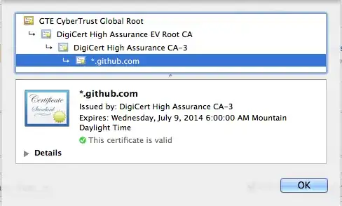

But gist.github.com works just fine:
Gist.GitHub.com works Gist.GitHub.com Certificate Information

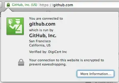

Everything works fine in Firefox.

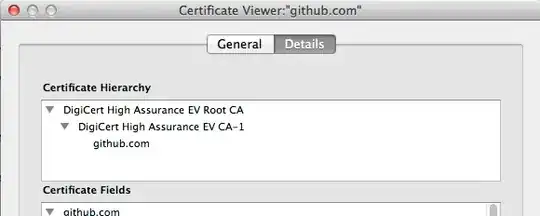

Here's what it looks like in Firefox:
Update:
I noticed that the first certificate in the chain is different in my broken Chrome/Safari as compared to Chrome on my other computer.
(There's no nasty red X anymore because I trusted it in Safari.) See how the issuers are different? What can I make of that?

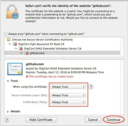

I followed Allen's tip but it did not work for me. So I try this. Looks like it works.
  1. Follow all Allen's steps.
  2. Open affected site on Safari (eg: github.com).
  3. It will promt you this alert box. Click 'Show Certificate'. enter image description here
  4. At 'When using this certificate:' dropdown, select 'Always trust'. All 2 dropdowns below will follow the same rule you have selected here. enter image description here
  5. Open up Chrome, try to access the affected site (eg: github.com).
I've tried this. Facebook loads normally. But, github loaded with no CSS. I get skeleton github. I do not know why this happen. But the connection is already established and okay.
Any idea guys?
