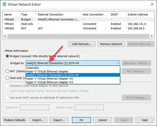

In 2022, with Windows 10/11, if the VMNet Bridge Driver is set to automatic, then a Hyper-V virtual adapter may be chosen to your detrement. However, if you explicitly choose an adapter, then you have one less point of failure in your debugging, or bridged networking may just happily work again.
select bridge adapter
