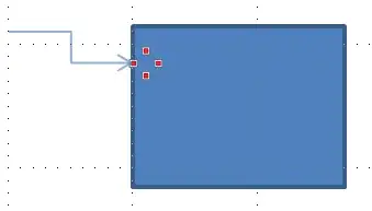

How can I add additional connector points to a shape in word or powerpoint?
In openoffice draw these are called glue points.
What I want in ms powerpoint:
What I can do in open office draw:
UPDATE: Based on Steve Rindsberg's answer I did this: Draw a rectangle, then a second one. Make the second rectangle very small and move it over, then behind the first rectangle. Then group them. I guess this is actually a functioning workaround for my question, even though it is not what I wanted to hear. Accepting the answer...

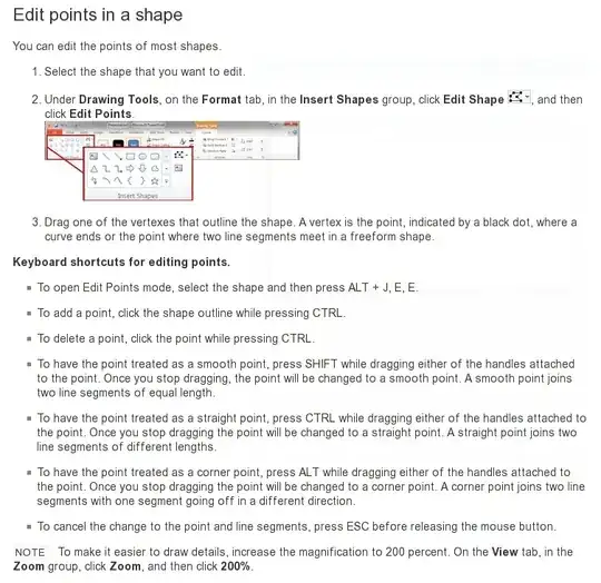

This description can be found at this link:
Edit points in a shape

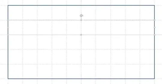

I had same issue and was annoyed with adding points method because of need to be very careful for spline interpolation between points (was really hard to make straight line and align points very carefully). So here is what I did:
[Step1]
Start to draw a rectangle with two smaller rectangles in it (add lines connected to smaller rectangles to get the big picture)
step1
[Step2]
Resize smaller rectangles to snap on edges of the bigger one
step2
[Step3]
Select no to draw contour for smaller rectangles (at this point I also removed helper lines)
step3
[Step4]
Group the rectangles in a single form
step4
[Step5]
Add this new form to your favorites
step5
[And voilà]
You can now connect lines at added new points
voila

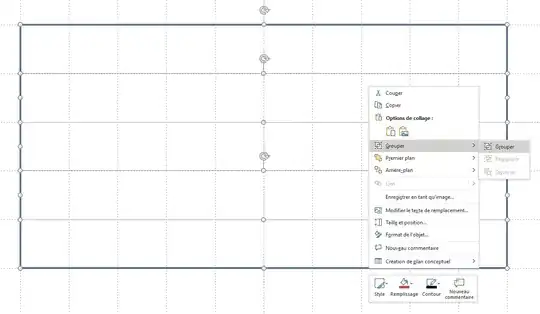

The "Add Point" super sucks, never use it. Just:
  1. create a tiny circle.
  2. Bring it to the front.
  3. adjust its transparancy to 90%.
  4. group two shapes together.
#3
#4
