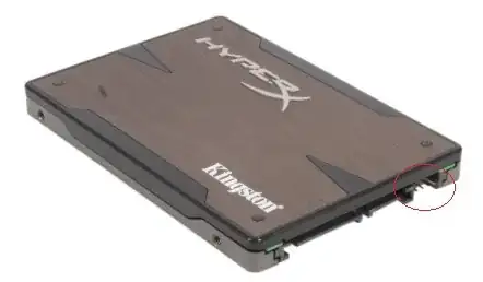

While searching for an answer, I found this question on SU what is the purpose of this 4 pin interface on sata hdds and why doesnt it exist on SSDs?
Well, on my Kingston HyperX SSD drive, they do exist.
hyperx
So if Spread Spectrum Clocking and reduced power spin up is not needed, what would be the function of these four pins?
All of my search attempts show only a few variants that apply to 2.5" spinning platter drives depending on vendor and none for SSD, to include the attached SU question.
Any ideas?

Partial Answer
I emailed Kingston technical support to get their answer on the subject
Thanks for contacting Kingston technical support. For those 4 pins, basically they do not have any function. Only SATA connector and power connector of SSD will be connected and used.
I Pushed for more information and got this in reply
Thanks for your reply. Our apologies but they are intended for any use or purpose.
I will make note that in the footer from the email It had 下午 2:02 (下午/xiawu means afternoon in chinese) so this information has come from china and I believe the first point of contact team is trying to say is that the port is not intended for any use or purpose but have done so in poor English however this is an assumption.
