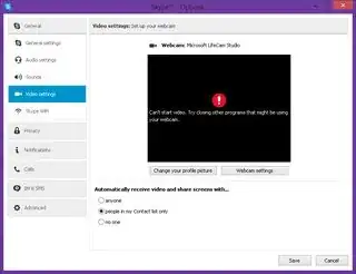

Let's start with the basics. When I attempt to view my video settings, I get the following message:
Can't start the video. Try closing other programs that might be using your webcam.

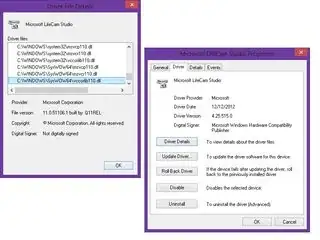

So I thought I had something when I discovered the following unsigned drivers. This turned out to pretty much nothing. I will be turning on the logging capabilities of Skype to see if I can capture a hardware event. The driver problem has been since resolved, and those six drivers now are signed.
