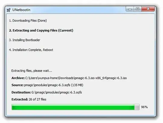

UNetbootin works very well, is easy to use with a simple wizard, and supports a broad range of Linux distros.

2It should be noted that unetbootin fails at creating bootable media of some distributions - even those explicitely listed as supported. If that happens, there are other available: Free USB installer - http://aligunduz.org/FUSBi/ Tuxboot (Clonezilla, Gparted live etc.) - http://tuxboot.org/ Linuxlive USB creator - http://www.linuxliveusb.com/ – Woozy Luke Jan 03 '12 at 18:41
virustotal.com scanning UNetbootin with one suspicious detection http://www.virustotal.com/file-scan/report.html?id=a9feaeb5dfaecd75e121cf7829a1b1be63122cb85e59ff74c68688a2d0ce71bc-1326151598 – Nam G VU Jan 10 '12 at 11:18
4Agreed with Woozy; unetbootin doesn't always work (the os x version has never worked for me). For Mac Users, I wrote a blog post about this a while back because I got tired of having to hunt this down elsewhere every time: http://blog.peelman.us/post/23452113677/make-a-bootable-usb-drive-from-an-iso-on-a-mac – peelman Jun 21 '12 at 18:26
If speed is a consideration, [Rufus](http://superuser.com/questions/66948/#439832), on their [website](http://rufus.akeo.ie), claim "Rufus is fast. For instance it's about twice as fast as UNetbootin". The programs website also lists a time specified comparison between UNetbootin and others @ http://rufus.akeo.ie/#ref1 – user66001 Aug 09 '13 at 18:03
Does Unetbootin for Linux wipe out the drive? This is important nowadays, as ISOs are typically under 2GB, and may people have existing backups on large (>64GB) drives, that they don't want to erase just to place an ISO. – Dan Dascalescu Sep 15 '18 at 02:01

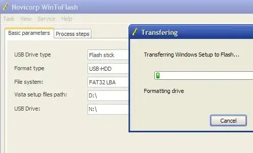

To create a bootable USB drive from Windows (any) installation disks, use WinToFlash.
It doesn't get any easier.
WinToFlash is freeware and portable.
If you only have the ISO image, mount it as a virtual CD/DVD drive (e.g. with WinCDEmu).
For Linux distributions, use the previously recommended UNetbootin.

20Malware Alert! Do NOT download WinToFlash from BetterInstaller! BetterInstaller infects your system and all your web browsers with a glut of MyStart Search toolbars and plugins, and reconfigures the default search provider to MyStart for the search box, address bar, etc. Just uninstall everything that says "MyStart", right? That's not even the tip of the iceberg. Several of them have sneaky names like "New Tab" (one of the Chrome extensions). It even sets MyStart as your homepage/new tab page. It's an enormous PITA trying to get rid of every trace of MyStart once it's raped your system. – rob Jan 13 '13 at 09:03

Try UNetbootin:
UNetbootin allows you to create bootable Live USB drives for Ubuntu, Fedora, and other Linux distributions without burning a CD. It runs on Windows, Linux, and Mac OS X. You can either let UNetbootin download one of the many distributions supported out-of-the-box for you, or supply your own Linux .iso file if you've already downloaded one or your preferred distribution isn't on the list.

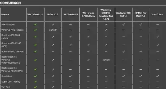

WiNToBootic for Windows:
WiNToBootic is a freeware that allows you an easy creation of bootable Windows USB hard or flash disk from an ISO image, CD/DVD or Folder. This product is focused on creation of boot disks based on Microsoft Windows NT 6.x OS family (Vista, 7, 8, Server 2008, Server 2012).
