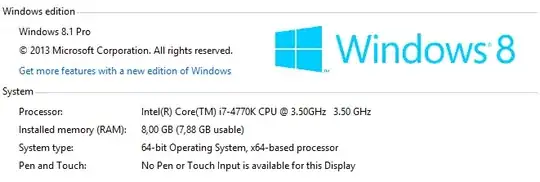

Hardware:
  • Intel Core i7 4770K
  • MSI Z87-GD65
  • Sapphire R9 270X Dual-X 2GB GDDR5 OC Boost Lite
  • Corsair RM750
  • Kingston HyperX Genesis 8 GB DIMM DDR3-1600
  • Samsung 840 EVO 250 GB
  • 2 hard drives for data (1 x 1TB, 1 x 2TB)

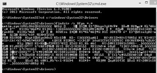

You will now see a screen resembling this:
You can see that the big issue here is the entry with tag Wfpn. If you have this as well then you're at the right post.
The next step is to find out what driver this is related to.
Open the command prompt (cmd.exe) and navigate to the drivers folder with
cd c:\windows\System32\Drivers
and locate the appropriate driver:
findstr /s Wfpn *.*
This should give you something like this:
We can now see that netio.sys is the culprit. After a quick google I came across a thread that discusses (and solves) this problem.
A user diagnosed this problem by booting in safe mode and recognizing that the issue was now solved. This meant that the problem was located in a driver that wasn't loaded. Using elimination it came to light that the Ndu.sys driver caused this problem.

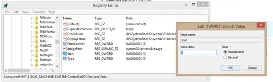

You can disable the driver by starting the registry editor (regedit.exe) and navigating to
HKEY_LOCAL_MACHINE\SYSTEM\ControlSet001\Services\Ndu
and changing the value of "Start" to "4", which will disable it.
Restart the computer and everything should work fine now (I just transferred 10GB worth of files throughout the network at 10MB/s and my memory usage didn't go beyond 35%).
