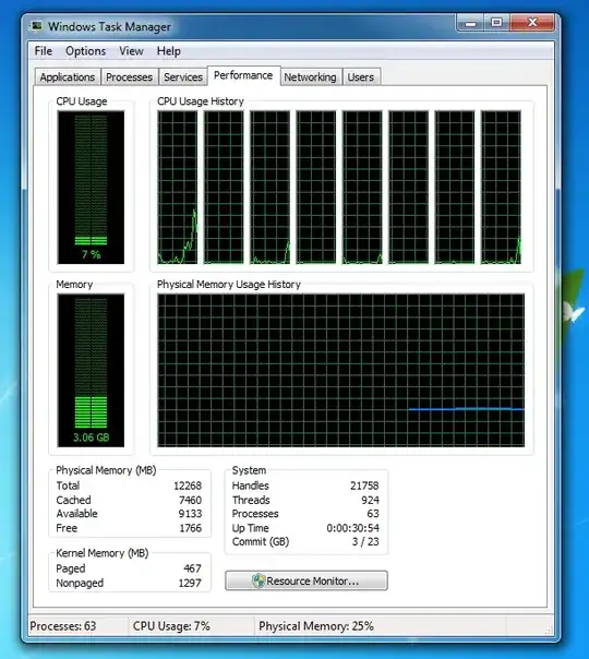

I have 16GB of system RAM. On startup with no applications open except the task-manager Windows is using about 3gb of RAM. I looked in the processes tab, but nothing seems to be out of the ordinary. How can I find out why my Windows is using so much RAM.
all processes from all users
Reading from the poolmon it seems that my wireless broadcom driver is using about 0.4GB of of RAM. Even if I remove it would still be using 2.6GB on start-up, which is still too much.
After reinstalling the wireless driver associated with the memory leak. I have a new screenshot and would like to confirm that it was indeed a memory leak.

    First of all, you only have 12GB. Either one of your four 4GB sticks is bad or poorly seated, or your motherboard doesn’t support 16GB. Second, have you tried running any security programs to check for malware? Security Essentials is built-in, so make sure to update its definitions and run a scan. Also try some anti-rootkit programs since rootkits specifically hide (though they also usually try to keep a low profile to go unnoticed, and using up a couple of gigabytes of RAM is hardly blending in). – Synetech Nov 12 '13 at 01:30

    The NDxx tags are ndis.sys. I'd guess BRCM was Broadcom. That would point to your network adapter being the problem. – David Marshall Nov 12 '13 at 13:54
  • ndis.sys is also a network driver. Add that to the Broadcom driver and that accounts for 1GB of your non-paged pool. Subtracting that would give you a more reasonable size. – David Marshall Nov 12 '13 at 17:36
  • @DavidMarshall NDft.sys also uses a lot of ram, what does NDft do? – Vader Nov 12 '13 at 18:14
  • ndis.sys is the network driver http://en.wikipedia.org/wiki/Network_Driver_Interface_Specification . The Microsoft pooltags are listed in pooltag.txt in the Debugging Tools \triage folder. The version I'm looking at doesn't list NDft. @magicandre1981 can give you some advice on using the Windows Performance Toolkit to dig down. Look if there is an update for the Broadcom driver. – David Marshall Nov 13 '13 at 09:20

  • I found the real problem. the resource hog is the Samsung SSD software magiccian – Vader Nov 18 '13 at 21:16
  • I had RAPID mode enabled, which allocates 1 gb of system RAM to speed up file writing. – Vader Nov 20 '13 at 14:04

You have a memory leak caused by a driver. Look at the high value of nonpaged kernel memory. In your case this is over 3.7 GB. You can use poolmon to see which driver is causing the high usage.
Install the Windows WDK, run poolmon, sort it via P after pool type so that non paged is on top and via B after bytes to see the tag which uses most memory. Run poolmon by going to the folder where WDK is installed, go to Tools (or C:\Program Files (x86)\Windows Kits\10\Tools\x64) and click poolmon.exe.
Now look which pooltag uses most memory as shown here:
Now open a cmd prompt and run the findstr command. To do this, open cmd prompt and type "cd C:\Windows\System32\drivers", without quotes. Then type "findstr /s __ .", where __ is the tag (left-most name in poolmon). Do this to see which driver uses this tag:
Now, go to the drivers folder (C:\Windows\System32\drivers) and right-click the driver in question (intmsd.sys in the above image example). Click Properties, go to the details tab to find the Product Name. Look for an update for that product.
If the pooltag only shows Windows drivers or is listed in the pooltag.txt ("C:\Program Files (x86)\Windows Kits\8.1\Debuggers\x64\triage\pooltag.txt")
you have use xperf to trace what causes the usage. Install the WPT from the Windows SDK, open a cmd.exe as admin and run this:
xperf -on PROC_THREAD+LOADER+POOL -stackwalk PoolAlloc+PoolFree+PoolAllocSession+PoolFreeSession -BufferSize 2048 -MaxFile 1024 -FileMode Circular && timeout -1 && xperf -d C:\pool.etl
capture 30 -60s of the grow. Open the ETL with WPA.exe, add the Pool graphs to the analysis pane.
Put the pooltag column at first place and add the stack column. Now load the symbols inside WPA.exe and expand the stack of the tag that you saw in poolmon.
Now find other 3rd party drivers which you can see in the stack. Here the Thre tag (Thread) is used by AVKCl.exe from G-Data. Look for driver/program updates to fix it.

Well, first thing, before I go into a more detailed answer. In your first screen shot, your Non-Paged Pool (a type of kernel memory usage) is at 1.3GB. That seems unusually high to me, especially for only 30 minutes after boot. I guess I could see NP Pool getting that high after an extended amount of use or with a program that was leaking like a sieve. To contrast, my NP Pool is usually between 100 and 200 megabytes, and my paged pool might be as high as 400 or 500 (and that is after having my system running without a reboot for weeks.)
You can enable a few additional columns in Task Manager by right-clicking the column headers, and choosing select columns. You should add Working Set (private), Working Set (shared), Commit, and NP Pool. I'd scan through all your processes from all users, and see if any of them have an NP Pool more than about 256KB. If you see any, especially any that are considerably higher, that might be the source of the problem, or at least part of it.
Your total working set, the amount of physical memory in use by a process, is the combination of the private and shared working sets (WS). Private is usually bigger for most processes, however there may be some that use a larger amount of shared WS. The two should normally sum to the total WS. Commit is the amount of your working set that has been committed to the backing store (in most cases, the Windows page file). Backgrounded applications will frequently have a greater Commit than WS, indicating that much of their paged pool has been swapped out of memory and into your paging file (which is pretty normal for desktop apps that have been minimized and not used for a while).
The Non-Paged Pool is memory that cannot, and never will, be swapped out of physical memory...that is effectively your permanent minimum physical memory usage. NP Pool memory often contains program code and critical sections that must be in physical memory to behave correctly or securely, special heaps, etc. Out of 60 processes, if all of them have 256KB of NP Pool memory, then your absolute minimum physical memory usage would be around 15,360KB. In most cases one or two apps may have a 256KB NP Pool, while most have less, often considerably less (or none). It is highly unlikely the system would ever page out the entirety of all processes working set, so don't ever expect memory usage to get that low.
It's using so much RAM because it is designed to do so. There is absolutely no cost associated with using RAM. In fact, used RAM is better than free RAM because the operating system doesn't have to do anything to use it. Using free RAM requires making it used which takes effort.
If you're thinking "I want my RAM free now so I can use it later", forget it. RAM does not have to be free now to use later. You can use it now and use it later. There is no tradeoff here -- there is absolutely no downside to using RAM.
RAM is kept used and directly switched from one use to another without having to go through the effort of making it free just to have to make it used again. Modern operating systems leave RAM free only when they have no other choice.

    @DavidSchwartz totally wrong answer. He has a memory leak by a driver – magicandre1981 Nov 12 '13 at 04:48
    @magicandre1981 How do you know it's a leak? It sounds like you are hearing hoofs and thinking zebras. 99% of the time, it's horses. – David Schwartz Nov 12 '13 at 05:33

  • @DavidSchwartz turns out my driver might be the resource hog. – Vader Nov 12 '13 at 16:10
