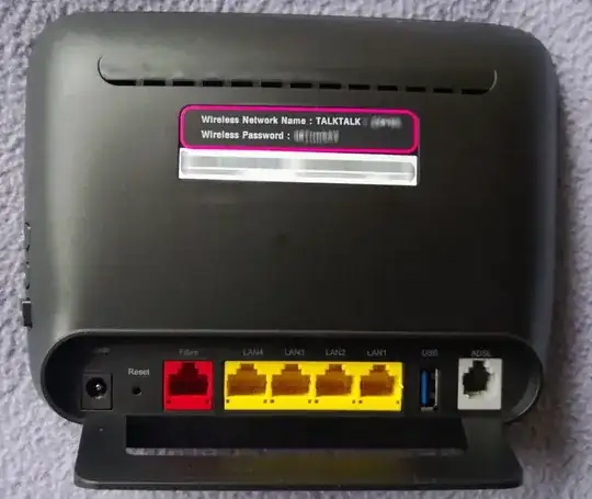

UPDATE: in response to CharlieRB's comment, here is a picture of the Unit B:

    When you say "connect the ethernet cable to the uplink", is there a port actually called uplink? Or are you referring to the ADSL port? Or is it the WAN port? – CharlieRB Jun 06 '14 at 13:14
  • There is one marked as "fiber". I believe it to be the uplink. It is a standard RJ45 though. I will upload the picture to my original post. – Art Gertner Jun 06 '14 at 13:53

    I had a look at your Huawei. Its manual is really economical... You want to try: 1) Disable the DHCP server on the Huawei. 2) Set it to bridge mode and make itself get its IP using DHCP from the D-Link Router or set manually to one in the D-Link's subnet. 3) DO NOT use the Fibre port. Connect the PowerLine adapter to one of the yellow sockets. – bot47 Jun 07 '14 at 12:19
