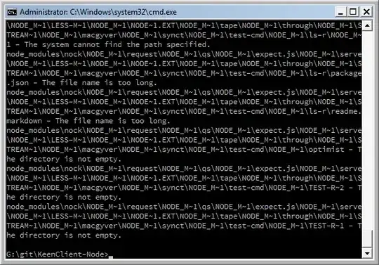

Trying Remove-Item in powershell gives the following error:
Remove-Item : The specified path, file name, or both are too long. The fully qualified file name must be less than 260 characters, and the directory name must be less than 248 characters.
At line:1 char:12
+ Remove-Item  <<<< -force -Recurse <directory>

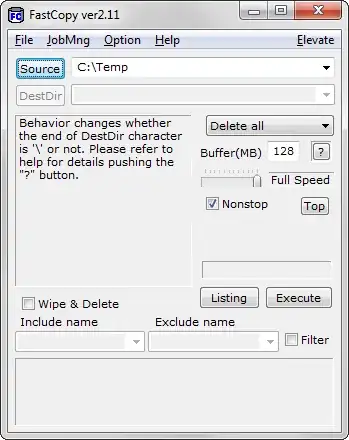

The tool that I used when I had this problem was FastCopy. I selected Delete All from the dropdown, selected the the directory I wanted to delete, and clicked Delete All.
FastCopy delete dialog screenshot
FastCopy is portable (no install required), and there are 32 bit and 64 bit versions available.

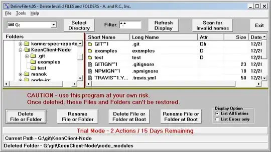

I've tried all the other answers, but they didn't work (atleast for me).
I came across delinfile and worked quite well and pretty quickly!
It's trial is limited to 3 actions / 15 Days but it's usable if you only wanted to delete a few folders/files:
