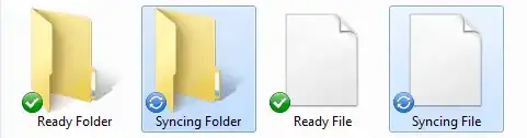

I have installed Dropbox, OneDrive and GoogleDrive. Overlay icons for all three applications were not working fine. Some icons were not showing. I was interested to show at least two icons for all three applications. Because these icons are most common.
  1. Synced! - (green)
  2. Sync in progress (blue)
So I changed my registry settings so that at least these two icons should work. To achieve this I have changed the order of overlay icons in registry.
I have made changes in following registry key.
HKEY_LOCAL_MACHINE > SOFTWARE > Microsoft > CurrentVersion > Explorer > ShellIconOverlayIdentifiers
The Top-Rated response was from 2014, and now it is 2019. Nearly five years later, we have 10 icon overlays now, up from 8 back in 2014.
The latest 2019 shell icon overlay descriptions are listed below: (See Photo)
The information in the photo above is correct as of Jun 26, 2019, verified with DropBox Advanced Support team via email inquiry. For continuous updated version, please see the Wikipedia page for a List of Icon Shell Overlays: https://en.wikipedia.org/wiki/List_of_Shell_Icon_Overlay_Identifiers
FYI: I also want to correct a misconception, there is 15 icon overlays alloted, but effectively only 11 icons available for other programs, because Windows System reserves 4 for itself. (15-4=11) according to official Microsoft support website. (archive URL) So only the first 11 icons ordered are listed, the rest are ignored.
rwat128
  • 179
DropboxExt1 - 4 are relevant to show the status of the folders and files (OK or in-sync mode). 5 - 8 show a red icon to show an error. I disabled 5-8, by deleting them from the registry and this works fine for me.

  • To be explicit, am I to understand: DropBoxExt1 - Ready Folder, DropBoxExt2 - Syncing Folder, DropBoxExt3 - ReadyFile, DropBoxExt4 - Syncing File ? If we wanted to clear some ShellIconOverlayIdentifiers then the Ready Folder and Ready File could go. I think this is becoming the default for Microsoft OneDrive (SkyDrive) now. – Sun Oct 14 '14 at 16:49
  • DropBox uses the same overlay for files and folders, the difference between the pairs 1/3, 2/4, 5/6 and 7/8 is the additional padlock for locked files, see [this answer](https://superuser.com/a/1037820/35237) – Tobias Kienzler Jan 24 '17 at 07:02
