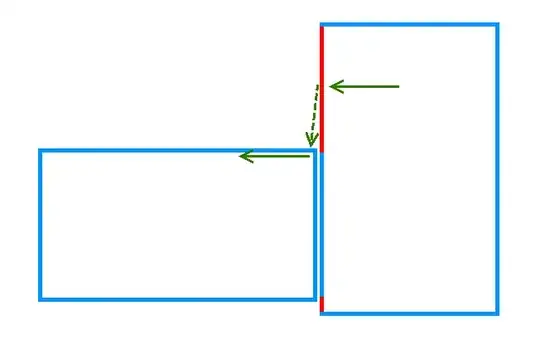

I have 2 monitors. The main one is horizontal, the secondary one is vertical.
When moving from the right to the left monitor, if the mouse hits the areas I've shown in red, it gets stuck. I would like to change this behavior.
Whenever the mouse hits any part of the tall monitor's left edge, it should be wrapped to the wide monitor's right edge. I don't particularly care where on the edge it gets wrapped: It's fine if it's just the closest point like I've shown in the image (dashed line is the wrap/teleport).
How can I do this?
