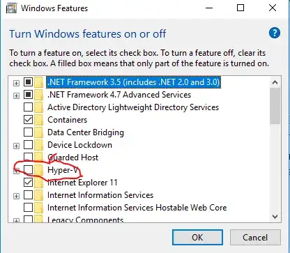

1To remedy this on my Win10 machine I needed to go into Control Panel\All Control Panel Items\Programs and Features and Turn Windows Features on or off. From here I needed to UNCHECK the Hyper-V feature that was installed. After rebooting the machine, the 64bit options were displayed – Malcolm Swaine Jun 21 '19 at 09:15
3In addition to disabling the Hyper-V feature in the Windows features, I additionally had to go to the Task Manager and manually stop all running "Hyper-V ..." services and the "HV Host Service" from the "Services" tab. After rebooting, the 64bit options were finally displayed. – KiraMichiru Aug 01 '19 at 09:18

- Hyper-V (or any other form of bare-metal hypervisor) is not installed

When Windows boots, windows key, type 'Turn windows features on or off', open it and disable HyperV:
Open VirtualBox, it should now allow you to specify a 64bit version.
