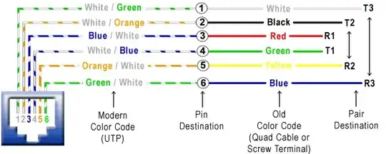

Spare Cat-5/5e/6? Sure. If you need RJ11 instead of RJ45, you'd need to snip off any existing RJ45 connection and replace it with an RJ11. For a single phone line, you only need 1 pair (2 wires) out of the existing 4 (but use a matched pair). For a 4-conductor/2-line RJ11, use 2 pair. For a full 6-conductor/3-line RJ11, use 3 pair.
Here's a wiring guide (source):
The colors are somewhat arbitrary; you just need to make sure you the the pairings in the right order at both ends.

  • +1. Good answer. When installing new network\phone wiring I always use CAT5e UTP as it can be used for both phone and network. It makes it so much simpler knowing you can use any jack for either one. – joeqwerty Jan 09 '10 at 19:47
  • Great answer, I think your answer saved me a lot of phone calls. I asked this because I thought there could be to much line resistance and signal distorsion. – Chris Jan 09 '10 at 20:58
    Additonally, if you're in a pinch, an RJ11 plug will physically fit, click and work in an RJ45 jack. Many moons ago we switched an ethernet run over to a POTS phone line for testing modems, and have been using it with the RJ45 jack for years now. – Ƭᴇcʜιᴇ007 Jan 09 '10 at 21:07
