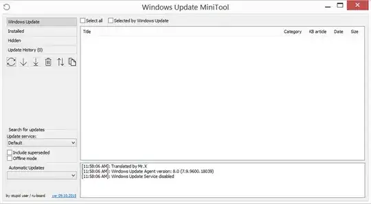

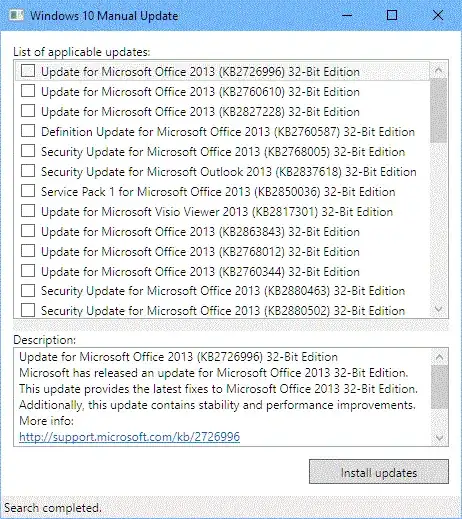

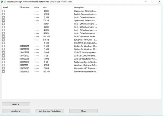

But there is a 3rd party tool called Windows Update MiniTool which allows to select which updates can be installed and allows to block updates like you could in former Windows versions.
An alternative to the standard Windows Update What you can do:
• Check for updates
• Download updates
• Installing Updates
• Deleting installed updates
Hiding unwanted updates
• Get direct links to the *.cab / *.Exe / *.Psf update files
• View update history
Configure Automatic Updates
• This tool is like the external powershell module PSWindowsUpdate, but much more advanced and user-friendly features
• The tool relies and use same WU infrastructure, all downloading are through WU it's not a downloader
The user slavanap posted a 2nd tool in a comment which allows you to selectively install updates. It is called Windows10 Manual Update and is available on github:
enter image description here.

    I don't think that MiniTool is open source. Please refer this open source the simplest solution how to perform Windows 10 Update maintenance similar to pervious Windows versions https://github.com/slavanap/Windows10ManualUpdate – Vyacheslav Napadovsky Nov 22 '16 at 14:10
  • @magicandre1981 Creator Update allows an Ethernet connection to be marked as a metered connection. And you know, automatic update does not work over metered connections. –  Feb 22 '17 at 13:43
  • @FleetCommand this is a crappy hack. Use the offered tools to search for updates. And don't don't sabotage the topic by adding softpedia crap links. – magicandre1981 Feb 22 '17 at 16:52
    @magicandre1981 Sabotage? That is not exactly a "thank you" for repairing a dead and dead-end link. –  Feb 22 '17 at 18:04
    -1 not because it's your fault, but because your answer is now out of date. Windows now turns Windows Update back on even after all the classic workarounds. – user541686 May 29 '18 at 02:50
    @Mehrdad it still works, you simply can't use WindowsUpdateMiniTool correctly ‍♂️ I've excluded kb4134661 with WindowsUpdateMiniTool and I'm still not updated to 1803 from 1709. Everything works fine. Delete your account and troll somewhere else – magicandre1981 May 29 '18 at 14:44
    @magicandre1981 with all due respect, I have one problem with your answer, it emphasises on deferring updates rather than stalling them – xavier_fakerat Aug 02 '18 at 15:29
    @TrevorBoydSmith the answer still works. I still use Windows Update MiniTool in 1903 home edition without any issues. – magicandre1981 Sep 18 '19 at 14:32
  • @magicandre1981 thanks for answering. i have retracted my comment. i will try out minitool! and report back (sry for wasting your time... i'm really thankful for your reply and showing that you care!). users like you make stack network amazing :). – Trevor Boyd Smith Sep 18 '19 at 18:27
  • @magicandre1981 MiniTool is a third-party software. Do you trust MiniTool? If yes, why? – Trevor Boyd Smith Sep 18 '19 at 18:30
  • @magicandre1981 i looked a little bit into MiniTool author/programmer. found a [reddit that says it works](https://www.reddit.com/r/Windows10/comments/9q2neb/windows_update_minitool_wumt_is_it_safe_and_does/). found a link to [winguru where an article about it writes "As far as I can tell, it involves an un-named Russian translator who maintains and handles the code base on behalf of an even more shadowy principal developer"](https://win10.guru/toolkit-item-windows-update-minitool-wumt/). – Trevor Boyd Smith Sep 18 '19 at 18:40
    The MiniTool might still work. But development has stopped and so an opensource alternative is available called: [article talking about MiniTool and WuMgr](https://piunikaweb.com/2018/09/20/windows-update-manager-wumgr-windows-10/) at [WuMgr at Github](https://github.com/DavidXanatos/wumgr/). – Trevor Boyd Smith Sep 18 '19 at 18:41
    I also know the other tool, as long as Mini Tool works I'll use it as it uses WindowsUpdate API. – magicandre1981 Sep 19 '19 at 14:22
  • I use minitool on all my W7-W10 machines, it just works and is safe, it is just a front end for the built in windows update, nothing nefarious about it. No virus detected either. Its the true solution to controlling Windows updates on W10. – Moab Mar 03 '20 at 15:50
    seems to be they have removed `notify to download and notify for install` option, only `notify for download and auto-install` left on 1909. Dunno if they are the same – Suncatcher Apr 15 '20 at 12:06
    @Moab, are you security expert to say it's safe? Just need to know for sure if it's safe. – Bohdan Kuts Aug 16 '20 at 09:53
    @BohdanKuts I wouldn't have said it if it wasn't. – Moab Aug 16 '20 at 12:13
  • Since the original author has pulled his blog an wumt, here is the continued project>>>>>https://www.majorgeeks.com/files/details/wumt_wrapper_script.html – Moab Aug 20 '20 at 15:50
  • The Group Policy Editor method does not work anymore. I had it configured: `7 - Auto download, notify to install, notify to restart`, but despite it updates are installed silently and windows restarts without my permission :( – Eugene Mala Jun 23 '21 at 19:41
  • @EugeneMala it works for all my systems (Build 19043, 18363) in VMs and on real devices. I prefer only to notify, bot to download. – magicandre1981 Jun 23 '21 at 21:16

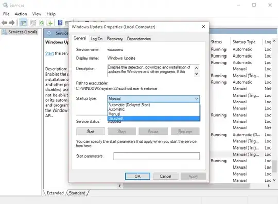

With the help of @Ramhound I have managed to figure out how to stop automatic updates on windows 10.
Please note this applies to Windows 10 Pro as it's the version I am running.
To stop the autmatic updates you can do the following:

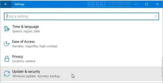

  1. Open Settings
  2. Click on Update & security
  3. Click on Advanced options enter image description here
  4. Ensure Defer upgrades option is checked enter image description here
  5. Close down the settings window and that's it you're done!

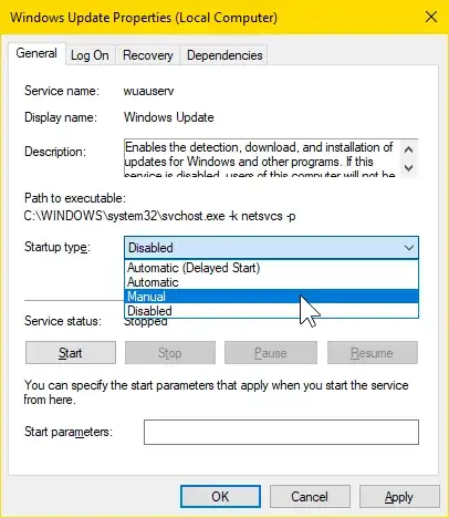

  • While your in there looking , could you see if there is a windows update service that can just be disabled in services. Wuauserv or wuaueng.dll or something? for those who might use a different method? – Psycogeek Jul 29 '15 at 17:08
    @Psycogeek `Wuauserv` service is there and can be stopped/disabled. This is how I originally stopped the updates – Izzy Jul 30 '15 at 07:59
    Much of the web is making it sound as if the world will stop turning , if the windows 10 updates are stopped :-) and how the button does not exist in some editions. I am assuming you did not have any trouble with that? the dream police did not invade your nightmares , the OS did not collapse into a ball, and no pets were harmed in the in the process :-) I think this Q&A here is well done and can be re-used for similar W10 update control questions . – Psycogeek Jul 30 '15 at 08:30
  • @Psycogeek LOL Love the comment.. I did not have any problem by stoping the service. – Izzy Jul 30 '15 at 08:52

unlike any other -DIY- updates "management"
windows_update_toggle.bat
@set @version=10.0 /* &title Windows Update Toggle
@echo off &set "verbose="
echo.
echo      ---------------------------------------------------------------------
echo     :                  Windows Update Toggle v10.0 final                  :
echo     :---------------------------------------------------------------------:
echo     :      Block/Enable Upgrades, Installs, Downloads(!), Service(!)      :
echo     :         Disable/Enable Reporting, Speech, SearchUI, Defender        :
echo     :        Hide/Unhide/Apply update lists with count and max size       :
echo     :       Preset for Defender updates and Store downloads working       :
echo     :                                                                     :
echo     :     Toggle from the comfort of Desktop right-click context menu     :
echo.
:: AveYo, 2018-05-13
if %1.==. timeout /t 10 &call wscript /e:JScript "%~f0" runas setup &exit/b &rem : no arguments, run setup elevated
if %1.==shift. shift &shift &rem : if loaded by WScript, shift args to prevent loop and restore %0
if %1.==. echo ERROR! &timeout /t 5 &exit/b : must have at least one arg
:: Setup executable blocking via ifeo
set notifier=EOSNotify MusNotification
set upgrader=Windows10UpgraderApp Windows10Upgrade WindowsUpdateBox SetupHost setupprep
set installer=wuauclt
set reporter=wermgr wsqmcons DiagTrackRunner DiagnosticsHub.StandardCollector.Service CompatTelRunner
set speecher=SpeechRuntime SpeechModelDownload
set searcher=SearchUI
set "exe=%notifier% %upgrader% %installer% %reporter%"
set "noop=%SystemRoot%\system32\systray.exe"
set "ifeo=HKLM\SOFTWARE\Microsoft\Windows NT\CurrentVersion\Image File Execution Options"
set "menu=HKCR\DesktopBackground\shell\WUT"
set "f0=%SystemRoot%\windows_update_toggle.bat"
set "task=wscript.exe /e:JScript \"%f0%\" schtasks WUT"
set "DefMUS={MicrosoftUpdateServer|MMPC|InternalDefinitionUpdateServer}"
set "DefMMPC={MMPC|MicrosoftUpdateServer|InternalDefinitionUpdateServer}"
set ".=>nul 2>nul"
for /f "tokens=2 delims=1234567890" %%# in ('shutdown /?^|findstr /bc:"E"') do set "[T]=%%#" &rem : cosmetic usage in menus
if defined verbose (echo on &set ".=" &set "window=") else set "window=hide"
call :%~1 %2 %3 %4 %5 %6 %7 %8 %9 &rem : launch secondary functions below dinamically, passing next args
echo.
echo Done! Use the Desktop right-click context menu to toggle, renew or uninstall
if "%~1"=="setup" (pause) else if defined verbose timeout /t 5

Last updated for v10.0 final. Up-to-date code on pastebin link above.
AveYo

Disable Update Service
  1. Win+R > services.msc
  2. Double click Windows Update and change the Startup Type to Disabled. To re-enable, go back to services and change it to automatic.
Source: How To Control Windows 10 Updates

Press WinKey+i > Update & Security > Advanced options (in the right pane).
Under Pause updates, it says :
Temporarily pause updates from being installed on this device for up to 35 days. When you reach the pause limit, your device will need to get new updates before you can pause again.

Next scroll down to HKLM\SYSTEM\CurrentControlSet\Services\wuauserv.
Right-click wuauserv, click Rename and add the suffix -BLOCKED!! so that the key's new name becomes wuauserv-BLOCKED!!.
Likewise, rename HKLM\SYSTEM\CurrentControlSet\Services\WaaSMedicSvc
to WaaSMedicSvc-BLOCKED!!.
Now press WinKey+i, click Update & Security, and then Check for updates.
Expect to get an Error encountered as in the screenshot below.
When trying to run Windows Update, expect an error.
If you see this error, it confirms that you have successfully disabled Windows Update.
The error was immediate when I tried this, but you may have to restart the computer for the change to take effect. Possible error numbers include 0x80040154, 0x80070002, 0x80070005, 0x80070424, 0x80080005.
3. How to enable Windows Update again
When you later want to enable Windows Update again, just rename the registry key back to its original name wuauserv. (You shouldn't need to rename/unblock WaaSMedicSvc-BLOCKED!!.)
Before renaming back, you have to delete the wuauserv key if it exists.
Don't delete wuauserv-BLOCKED!! or WaaSMedicSvc-BLOCKED!! 4
After renaming back, you need to make a software restart (WinKey+x followed by u and r) to activate Windows Update again.
Note!
A hardware restart – just shutting down and then restarting by pressing the physical power button – will not start Windows Update.
What if you still get Error encountered?
What if you unblocked the wuauserv registry key, restarted the computer (WinKey+x, u, r), and still get Error encountered when trying to run Windows Update?
Remedy: check that the Windows Update (wuauserv) service is running, as follows.
Open Windows Services, press WinKey+r, type services.msc (and hit Enter).
Sort by name, look for Windows Update and double-click that service.
If the wuauserv service is disabled, you need to set it to Manual.
In 'services.msc', Windows Update must not be disabled.

Here is solution for Windows 10 Home:
https://github.com/WereDev/Wu10Man
this is up to date (2020) open source program that can disable the Windows Update service.
