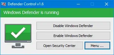

After trying heaps of methods both here and on other sites, I've finally found something that works (tested on v1909 and v2004)!
Sadly it's a 3rd party program but it's a portable EXE with GUI or can be run by command line.
Defender Control 1.6
Defender Control is a small Portable freeware which will allow you to disable Windows Defender in Windows 10 completely.
