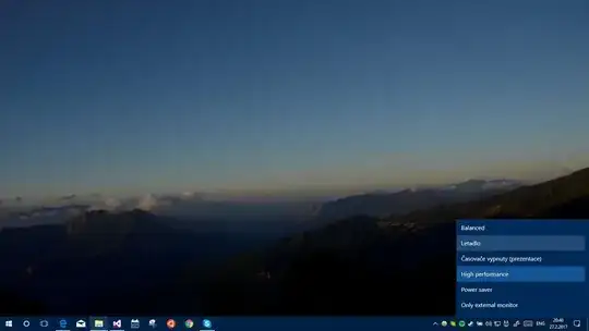

Wow! with all respect to all the answers, this should be by far the easiest. Just right click on the Battery Icon in the Task Bar and choose Windows Mobility Center. Super Simple!
For those keyboard shortcut Gods, you can also do Win+X > B
