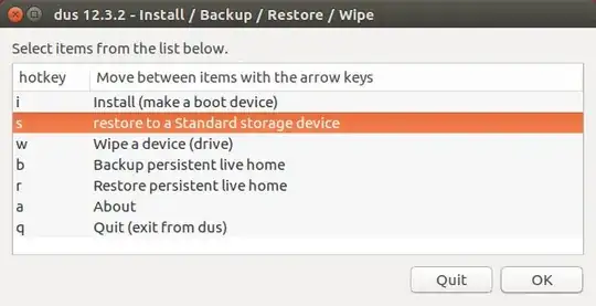

Install and use mkusb (mkusb-dus), which can format alias restore a drive to a standard storage device (with an MSDOS partition table and a partition with the FAT32 file system). These instructions are relevant for many kinds of drives (USB pendrives, memory cards, hard disk drives, HDD, solid state drives, SSD), but probably most often used for USB pendrives and memory cards.
If you run standard Ubuntu, you may need an extra instruction to get the repository Universe. (Kubuntu, Lubuntu ... Xubuntu have the repository Universe activated automatically.)
sudo add-apt-repository universe  # only for standard Ubuntu
sudo add-apt-repository ppa:mkusb/ppa  # and press Enter
sudo apt-get update
sudo apt-get install mkusb mkusb-nox usb-pack-efi
See these links with more detailed instructions,
mkusb version 12 alias mkusb-dus: enter image description here
mkusb wipes the first megabyte as a first step of restoring it
Sometimes some data are 'tricking' the software to think that the drive does not work, even when it is good, and it is enough to wipe the first megabyte to get rid of those data. You may 'look at' the drive with a tool, that does not recognize or understand correctly the structure of the partition table or a system, for example
  • if it was cloned from an iso file, or
  • if there are traces from a RAID configuration on the drive.
So you can
  • let mkusb restore the drive to a standard storage device (a convenient standard solution), or
  • let mkusb wipe the first megabyte and after that use another tool, if you want another partition table and/or other file systems. gparted is a good tool, if you are running a graphical user interface (window manager or desktop environment).
