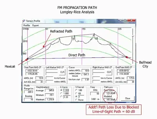

Below is an extreme example of refraction in the VHF range.
Although the line-of-sight path there is severely shadowed by Earth curvature plus several terrain obstructions, enough radiated energy may reach beyond those obstructions to provide a useful signal to a suitable receive system.
