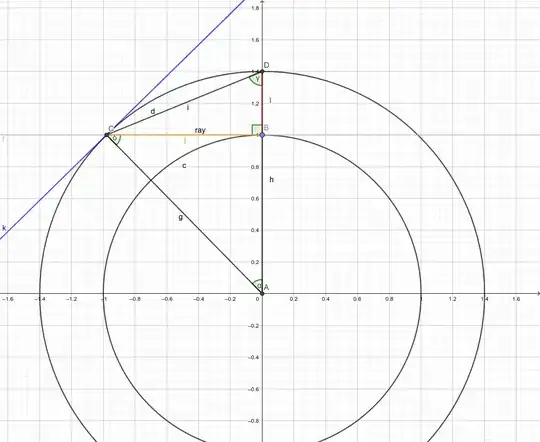

Geometric drawing
So, in this drawing, you stand at point $B$, and hold your laser pointer straight vertically (that is, perpendicularly to the planet radius $\bar{BA}$. At point $C$, the ray hits the saltwater-air interface in the angle $\delta$.
Our job is now to find $\delta$, because we know the refractive indices of air and saltwater, and we can then calculate under which angle the ray will leave the saltwater¹.
We know that on the saltwater-air-interface, the ray will be refracted away from the normal, that is, closer to the ocean surface. So, the ray will already have one "bend", that looks like it "hugs" the ocean surface curvature a bit.

¹ I haven't had the time to properly test my calculations, but if they are correct, that angle is, if we set the earth radius to 1, $\delta=90° - 2\arcsin\left(\pm \sqrt{\frac l{2+2l}}\right)$, but that's actually not that important here. If you want to have some geometry in your presentation, deriving that angle from the ratio of earth radius (set arbitrarily to 1) and water height would definitely be a cool thing.
For the things I want to explain, it's not important what this angle is, exactly.

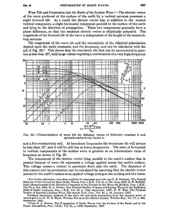

The sections on the propagation of radio waves included in the Radio Engineers' Handbook 1st Ed., 10th Impression (1943) by F. E. Terman present a detailed analysis of this subject which may be useful here. A clip from it with his opening comments about "wave tilt" is shown below.
A Google search will identify sources for this complete textbook in printed form; possibly even as a free download in PDF format.
Radio Engineer' Handbook, page 697
