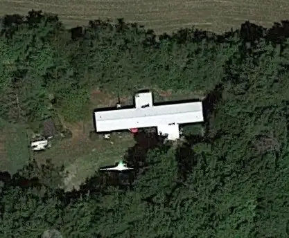

I've got, for the near term, limited resources to put up an HF antenna at my home. One of the options I can manage without excessive cost is a loop, which would enclose the house. I need to transmit on 80m, and likely up to 20m (I understand loops are very tolerant of shorter wavelengths). It wouldn't be as high as I'd like, so would probably perform more like an NVIS, with poor horizontal radiation (given I live in a draw, that's not entirely a bad thing, as less of my energy will go into the ground where it rises).
The only thing is, the space I have pretty much requires the loop to enclose the house, if I'm to avoid entanglements in the dense pine/hardwood mix that covers more than half the lot. How will the steel roof (about 5x20 meters) affect the radiation of an 80m loop (probably hexagonal), mounted close to roof height (roundly 3 meters above ground)?
I'm not certain of the grounding status of the roof panels; it was applied by a "handyman" who seems to do no better work than is expected of him (that is, if you don't know it's wrong, he won't do it right), before I lived in the house.
Here's the property aerial view; the bright white roof with two extensions is mine. The property line follows the fence parallel with the driveway, the near edge of the line of trees next to the plowed field North of the house, and loops into the heavily treed area S and SSE (mix of pines and hardwoods, tangled branches, difficult to run wire into).
Aerial view from Google Maps

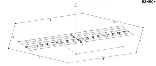

I simulated a 3.8MHz 1-$\lambda$ hexagonal loop (no wire loss) mounted 3-m above medium-conductivity ground, surrounding a 5m x 20m grid of wires as shown here: enter image description here

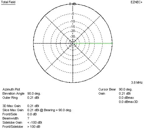

Because the loop is so close to the ground (in wavelengths), the 0.2-dBi maximum radiation occurs at the zenith. enter image description here
dropping to -3-dBi at 45$^\circ$ elevation angle. The gain increases less than 0.25-dB when the wire grid is removed, a small change as expected from the low currents reported in the grid wires.

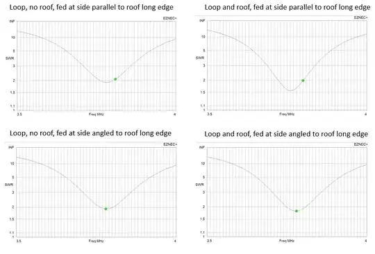

SWR calculations show that the "roof" does have a meaningful effect on the loop's characteristics:
Feeding the loop at the mid-point of a side parallel to the long edge of the "roof" gives somewhat better SWR than feeding the mid-point of one of the "angled" sides, so the loop must indeed be exciting meaningful current in the grid wires. It's possible that the slight gain decrease with the wire grid is due to ground losses, which would couple into the loop, lowering the Q and the efficiency of the antenna. Conversely, feeding at a corner of the loop has minimal impact on the SWR curve, regardless of the presence of the wire grid. The antenna's feedpoint impedance varies considerably as the band is changed; a wide-range antenna matching network will probably be required.

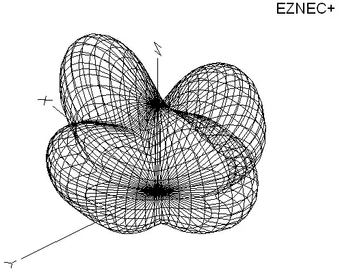

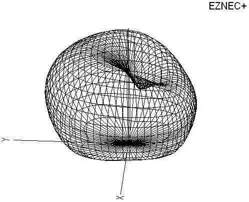

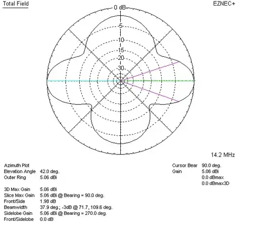

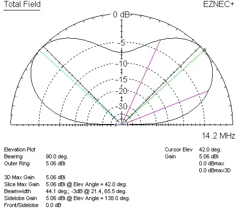

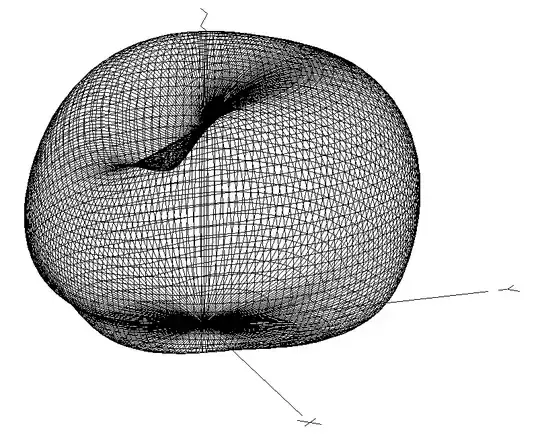

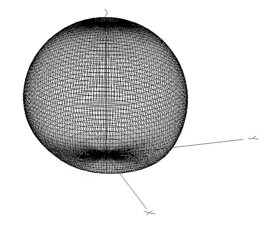

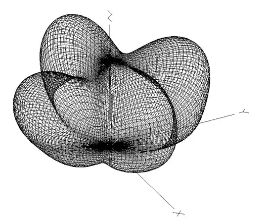

At the request of another SE member, here are 3D plots that show how the pattern evolves as the frequency is successively doubled:
7.15MHz - maximum gain ~0dBi, impedance 152.6 - J 423.1 ohms
14.2MHz - maximum gain 5dBi, impedance 439.3 - J 1106 ohms

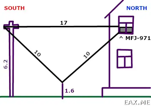

I've tried such an antenna not a long time ago, here is a scheme:
It works on HF bands from 80m to 10m, although it's not very efficient on 80m. I used a 10m fiberglass fishing rod as a mast which costs ~45$ on eBay. As I understood you have trees near your house thus probably you don't need a mast.
(Note: For 80m double the length of the loop, the distance from the ground and the mast height.)

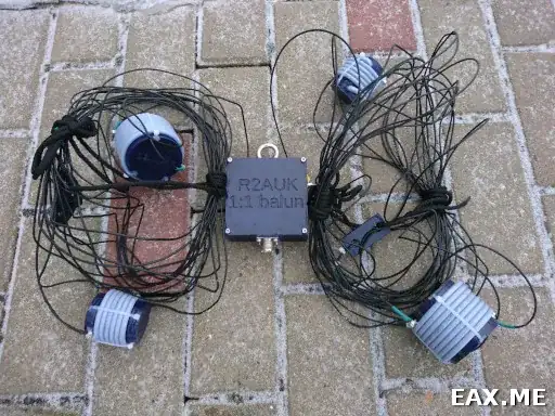

Another option that doesn't require a tuner is to build a trap dipole. I've built such a dipole for 20, 40, 80m bands once. The antenna turned out to have total length 27.5m. It also worked on 10/12/15/17/30m bands with SWR about 2. It's enough to place the balun about 6-7 meters above the ground, although for better performance on 80m it's better to place it higher.
Hope this will help. Good luck and 73!

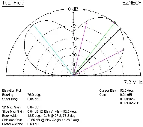

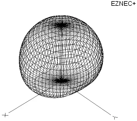

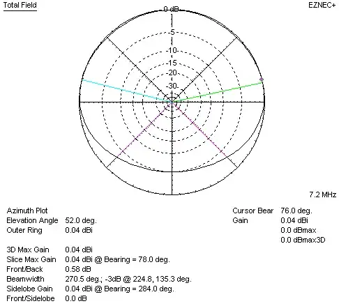

To add to Brian's fine answer, I'd like to share some two-dimensional plots to complement his answer and 3D patterns.
To me, 2D plots are also necessary, because they show the actual takeoff angle vs. gain. Generally speaking, the lower the takeoff angle, the farther away that you can work DX.
75 Meters
As was expected by most of us who have decades of experience on the HF bands, this is not an optimum antenna for DX on this band because it is so low in terms of the ratio between its height and wavelength. On 75/80m, it's pretty much omnidirectional and most of the radiation goes straight up. It's an NVIS antenna. Depending upon the time of day, it can work well for stateside work within, say, 750 miles.
75 meter 3D radiation pattern
75 meter 3D pattern
75 meter 2D elevation pattern, gain vs. takeoff angle
75m elevation pattern
75 meter 2D azimuthal pattern, looking down on the antenna
75m azimuth pattern

These pattern plots are based on the same EZNEC+ model that Brian was kind enough to share with me.
An important word about the gains
Notice that the gains in these pattern plots are in dBi. That means the gain over a theoretic isotropic antenna. A dipole has a peak gain significantly higher than an isotropic antenna, at the expense of nulls off the ends.
