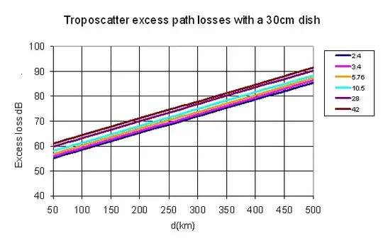

Mike Willis has a great article on troposcatter, which includes all sorts of empirical models and stuff. However, it's nicely summarized by this graph:
Troposcater excess path losses with a 30cm dish
These are losses in addition to the ideal case we just calculated. For our example of 150km, we can see losses of about 62dB. That brings the minimum EIRP to 123dBm, or again assuming our 40dBi antennas, transmitter power of 43dBm.
Certainly feasible, even after adding margins for noise. With higher gain antennas, on the edge of possibility with consumer equipment.
