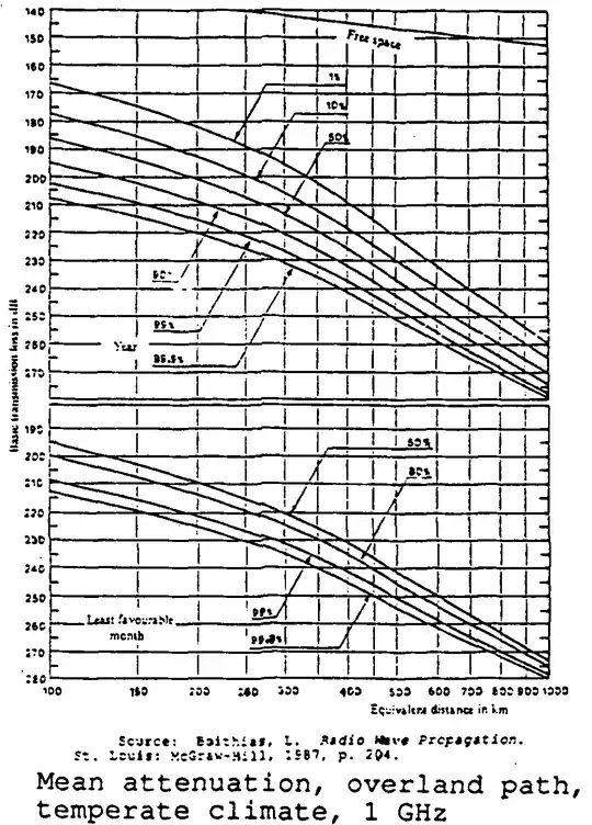

After inspecting the summaries on the different models, I think that for VHF, UHF frequencies, probably what the call CCIR method II (by Boithias and Battesti) is what I'd want to look at. However, best graph I could produce on short notice (p.162 from that thesis):
att CCIR method II
for other frequencies, a factor of $30\log f_\text{GHz}$ is added.
so, I'd need to add another 3 dB; OK. Now, going for a < 1% outage time, I'd have to read both the upper (year average) and lower (worst month) chart's lower two curves (99% and 99.5% temporal availability). That yields something between 212 dB and 216 dB (average) / 218 dB to 222 dB (worst month) attenuation for a 150 km link.
Now, assuming we don't want to overdo it with antennas, an antenna gain of ~ 18dB on each end sounds realistic. Swinging with -220 dB tropo path loss, we thus get an overall loss of -184 dB.

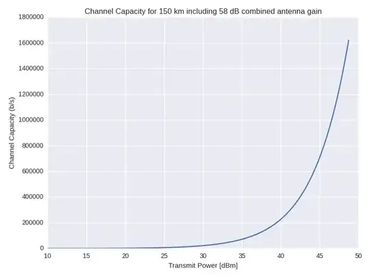

Ok, rough capacity estimate:
channel capacity
Rolling a few numbers in my head, assume we want to get a code bit rate of let's say 200 kb/s. We'd want to stay a solid factor of 4 below the channel capacity (please correct me!), so that requires about 46 dBm transmit power – 40 W.
I don't think the atmosphere will allow for reliable amplitude estimation, (please correct me!) so I'd roll with QPSK for an initial estimate.
That gives me the rough feeling that we have plenty of headroom (like, 99 times what we use) to add robustness – be it through spreading, channel codes, or stupid spectral repetition.

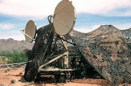

I also was not able to find any details on the channel besides loss. However, I see many examples of military systems like these:
Some are mounted on trucks. I've read each horn has two polarities. We can infer the quad antenna diversity setup is to counter channel fading which must be significant. Although, the military certainly has higher reliability requirements than an amateur. HF channels have similar properties and that hasn't stopped anyone.
