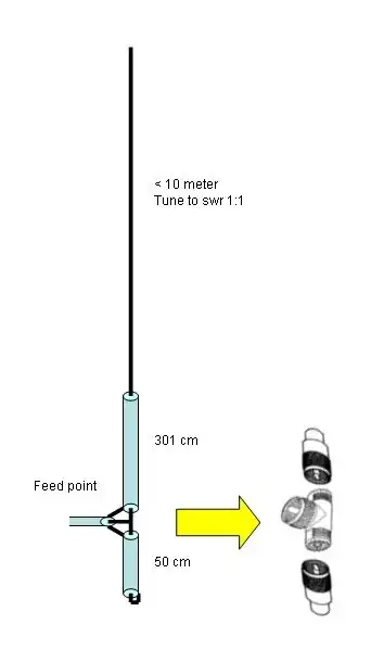

I'm trying to build a 1/2 wave "Coaxial J-Pole" antenna, similar to what is described here:
Coaxial J-Pole
Such an antenna would be great for stringing up in a tree when operating remotely, no tuner needed.
The trick is that I'm trying to use 75Ω RG6 coax for the matching section (because it is relatively inexpensive and low-loss), but I want a 50Ω impedance at the feed point.
There are many single-stub matching network calculators, but almost all of them assume that the impedance of the matching network is the same as the feed point impedance. I know that such a matching network is possible because that is exactly what the traditional j-pole antenna is: a single-stub impedance transformer feeding a half-wave antenna, where the matching section impedance doesn't match the feed point impedance.
Succinctly: How can I calculate the physical parameters of a single-stub impedance transformer when the matching section impedance doesn't match either the feed point impedance or the load impedance?

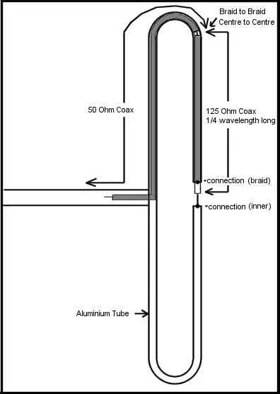

As an interesting example, VK6UU gives an example of a 300Ω folded dipole matched to 50Ω by way of a quarter-wave section of 125Ω coax.
This works because relative to 125Ω, 300Ω and 50Ω are (approximately) duals, that is they have the same magnitude reflection coefficient, but 180 degrees apart. You'll notice:
$$ 125 / 300 \approx 50 / 125 $$
A little more generally, a quarter-wave section of transmission line of impedance $Z_0$ converts between two impedances $Z_a$ and $Z_b$:
$$ Z_0 / Z_a = Z_b / Z_0 $$
which can be algebraically solved for $Z_0$ as:
$$ Z_0 = \sqrt{Z_a Z_b} $$
So for the special case of a quarter-wave section where you can pick the transmission line impedance, this is how you can match two impedances.
