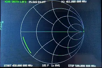

  1. Impedance of the cable, open circuit, when the VNA is calibrated at its own port:
    Note 1. the cable loss (the open end reflects all the power, but some power doesn't make it there, or back, becaues of the loss, so it's not on the edge of the chart) and 2. the cable length (lots of turns when it should just be an open circuit)

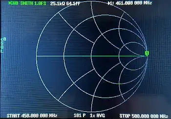

  2. Impedance of the cable, open circuit, when I've calibrated to the end of the cable:
    A nice open circuit.

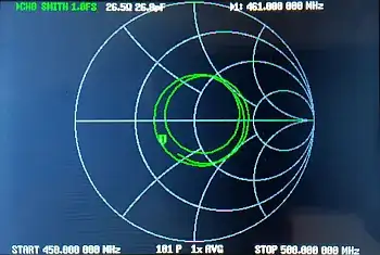

But what if my antenna isn't quite at the connector I've just calibrated to? What if tt includes a short piece of cable itself, or just the body of the connector (which I can't disconnect). Here is how you remove that cable too:
  1. I connect the antenna and short-circuit it with a knife:
    Note that this does not look like a short circuit! So when I remove the knife to see the antenna impedance, it will be all wrong.

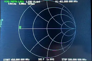

  2. Adjust the electrical delay to get a good short circuit, with the knife in place. I used 3 ns which is the round-trip time of a 1 foot cable. See the Edelay line at the top of the screen.
Now remove the short circuit and you should see the true antenna impedance measured exactly at the feedpoint.
